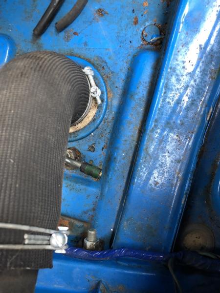

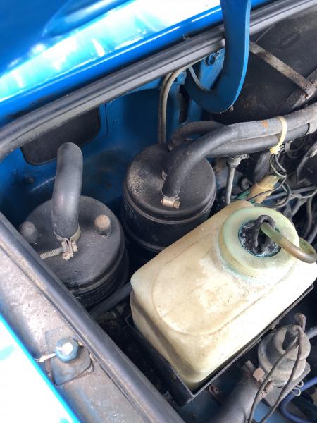

HI Everyone, I am a proud new owner of a 78mgb . I am far from being a car guy and do my best to repair as much as i can. This MgB has lots of little issues (mainly electrical) so I thought I would start with fuel smell in the compartment.
1. After reading great stuff on here, I believe I have found the problem. In the trunk on the right side near tail light is a silver canister. I'm guessing it might be a charcoal filter although in the pictures attached I thought the filter was up front. Anyway. I discovered all the tubing has rotted and was broken off. Can you please tell me what the hosing configuration is. Am I right in thinking that hose goes from tank up to canister (either entry?) then from canister to the silver vapor line? BTW I connect a hose to the main silver line and was able to blow through the line, which I am guessing is a good sign that there is no obstruction unless I shouldn't be able to?
2. the black canisters in the front of the engine, Is one of those also another charcoal?

Grantura_MKI
One in the boot is vapor. Black one in engine bay is charcoal canister.
Vapor hose top goes to charcoal canister and lower to gas tank.

Platinum
Welcome, MARTY, and Grantura's post gives you the right info. The rear canister is a "condenser" of sorts, the lower port sends condensed vapors from the front mounted charcoal unit, condensing it back into the tank as liquid fuel. Renew all the 'perishable' (rubber) lines in the Evaporative Loss System and report back as to the result.
Use more effective Zebra or the spiral screw clamps like the one on your front charcoal canister to replace the factory ones on all connections as well. The original clamps are great for mass production, not so great as a long-term answer.

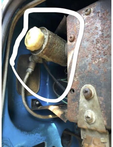

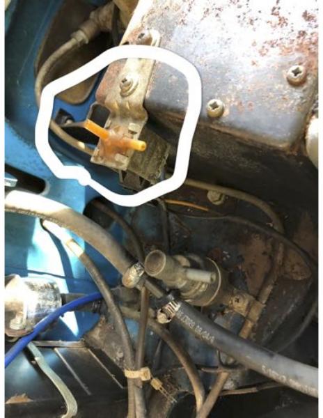

Hi everyone, just wanted to say thanks. Your help is priceless. So as I continue I have more questions.
1. I have attached a couple of pictures. my questions are as follows. There is a valve I'm guessing that is air or emissions related, should there be hoses coming off the little square valve. ?
2. The refillable container in the second picture, what is that used for? I stuck my finger in and it is pretty empty...do I need to fill?

Grantura_MKI
Yes, it needs to be topped up with the correct fluid. Use Castro LMA.

Grantura_MKI
Square item with hose ports is for your vacuum advance. It should have hoses connected.

Joe Reed
If your clutch master cylinder reservoir was that low you should probably inspect the slave cylinder and the clutch hose. That fluid had to go somewhere....
That piece with the hose connections on the side of the pedal box is part of the original TCSA (Transmission Controlled Spark Advance) system. Originally, the vacuum advance hose from the distributor would connect to one side and another hose from there to the intake. There is (or, at least, was) also a switch on the transmission that closed only when the transmission was in 4th gear. That switch energized the one pictured to allow vacuum to the distributor when in 4th gear, but not any other gear.
Those are often disconnected or missing, but you'll probably need it to get through inspection in CA. Sorry.....
