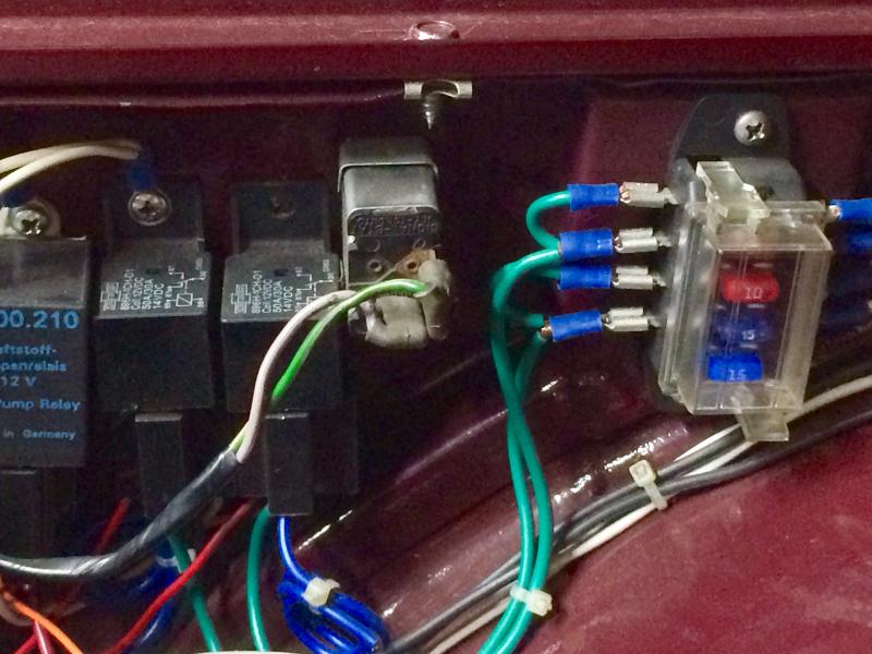

Here's the relays I installed. On the far right is the fuse block; each side (L and R) has fuses for both hight beam and low beam.
The headlight relays are the two relays with white lettering to the right of the relay with the blue text.

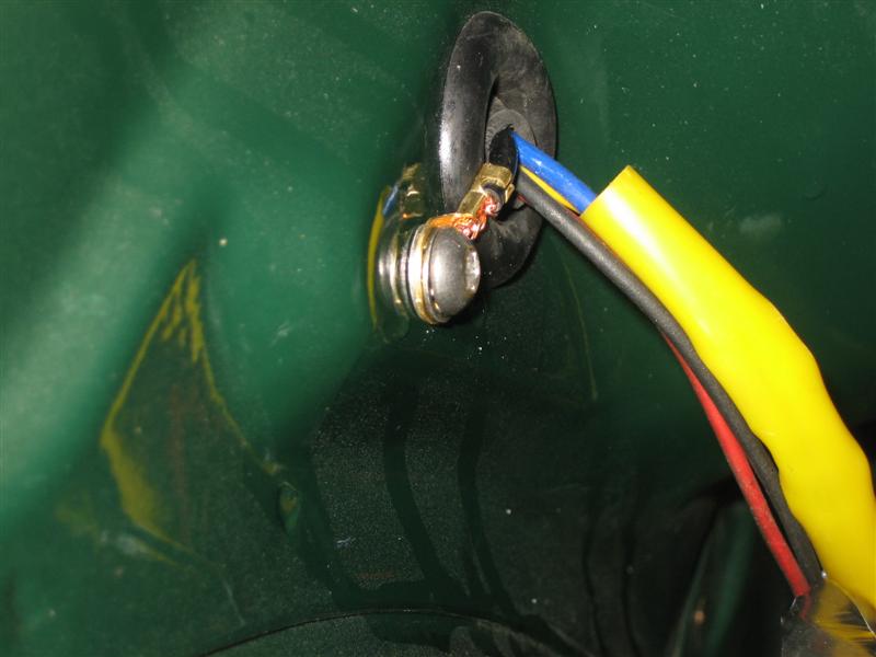

Just as food for thought, here is my "stealth" relay installation. With them mounted on the headlight buckets, the only thing visible under the hood is an extra purple wire running towards each headlight. Yet access to the relays is excellent, once I remove the headlight buckets. (Not that I ever expect to have any trouble with them.) Although I had sockets, I decided the individual wires made a more sanitary installation.
