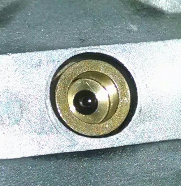

    Didn't want to trust the chokes to pull the jets down the exact same amount, so I used the mixture screws to lower each jet to 3/16" (.1875"). Seems counter-intuitive, but I had to bend the float arm upward to raise the float in order to lower the level in the jet. Was able to get them both to look like this. Blowing on the fuel further helps to make sure both levels are the same.

    At first glance, that looks like an alien eyeball.

    That jet setting looks way low to me.

    I suspect Steve simply lowered the jet using the mixture screws to set the height of the fuel as I indicated in my discussion above. I’m sure he then adjusted the jet height back to achieve the correct mixture setting for his car.

    Apologies for lack of clarity. Tony is correct. After setting the floats for equal fuel level in the jets at .1875", I raised both jets back to .082"
