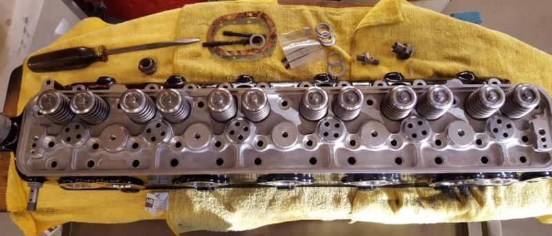

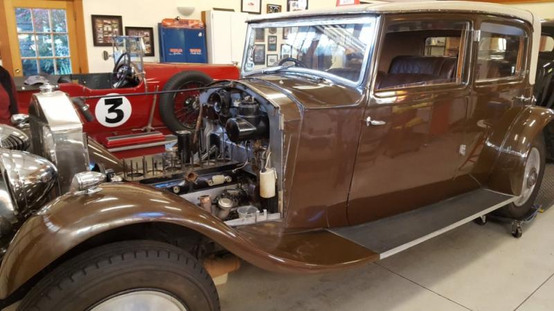

Here's the new head, and a shot of the car with the 1924 Speed behind it. Easier to see than during the video.
Another interesting thing on this car is that it has both a generator (big one) and a magneto, and a male plug that comes from each so that you can manually switch one out for the other.

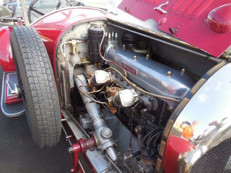

Also, it has an interesting valve train. As you can see from the photos, it has overhead valves but they are not adjusted in the rocker assembly but down below the pushrods (a bit like flat-heads) from the side access panels.
I think the cast-iron head was about 130 pounds and the aluminum one about 30 pounds (approximately).

To me the 1924 3-liter Bentley Speed Model is the most impressive, and WAY ahead of its time.
