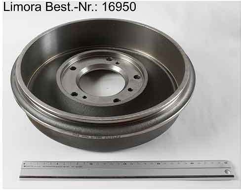

These are some of the signs of Scuttle Shake which is often related to imbalanced brake drums. Although this tremor could be caused by a number of balance issues, the most common and overlooked is that of rear brake drum balancing. Factory and most replacements drums are not pre-balance and the Healey's rear brake drums are rather large and heavy. Since their size and weight is non-trivial, this imbalanced component transmits its issues through the springs and drive train to the car and shows up around 50 to 65 MPH. The severity of the imbalance, and resulting shake, is not constant as the left and right drum will constantly shift their relative position and counterbalancing relationship via the operation of the differential.
Since drums of this size and weight are no longer commonplace, finding a servicer to correct and balance these drums is not as easy today as years back when drums were commonly used. Look in your location for a servicer who can perform drum balancing as it requires securing weights to the drum in a secure manor that allows for heat expansion and contraction. If no one can be found, many Healey owners have gone to Hendrix Wire Wheel (hendrixwirewheel.com/drums.html) for this service.
Be aware that many local services will indicate they can cut the drums and this should solve the issue. However, cutting usually does little to resolve the problem and you need someone that is experienced in applying balancing weights to the drum.

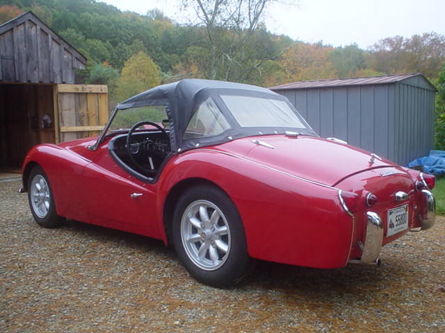

Another thought: I had the 55mph front end shake on my 1959 TR3. New tires, tires trued and balanced, suspension/alignment trued, u-joints replaced - no improvement. Original steel wheels.
Turned out that the wheels themselves were bent, probably from hitting chuck holes and curbing in the previous 50 years. Easy to check: raise the wheel, spin and point your finger toward the rim. If the rim moves back and forth from your finger, the wheel is bent.
I bought new wheels, and the shaking completely disappeared.

Normally, Healey original brake drums, or their replacements, are not ballanced from the vendor. This is something overlooked by many as full 4-wheel disk setups came into common use. I would address your vendor and ask if they know if your new drums have been balanced prior to purchase. Keep in mind that many vendors will profess the quality of their parts and suggest they have had no prior complaints … stopping short of indicating a guaranteed affirmative. Either way, I personally search out a drum balancer to validate it had been done.
As an original owner of my BJ8, for years I just assumed the drums were both truly round and balanced and were not the source of my shake. Finally, a mechanic friend and Healey enthusiast dynamically balanced each drum attached to its wheel with a fixture I created. Since both were balanced as a unit, weights were applied to the wheel making it necessary to keep the wheel and drum in the same relationship position when mounted on the car … a definite draw back for this approach.
Get your drums balanced individually to have the ability to exchange wheels and/or replace tires without affecting the drum's balance.

Since you have 2 imbalanced rear drums connected through a differential, every time you make even a slight turn, the heavier area of one drum will change its relation to the heavier area of the other. As a result, your perceived shake will then change in intensity due to this change in relationship and vary from intense to slight. If the shake remained consistent, I would look to an imbalanced single unit such as a drive shaft, flywheel, etc.
This is not a new issue and all of us have, at one time, never expected the drums as the culprit. However, since we have all searched for the cause and found it, you can benefit from our efforts and go directly to a resolution.
