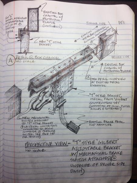

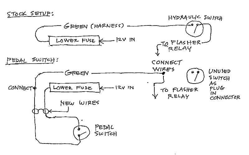

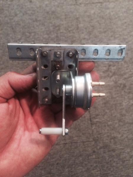

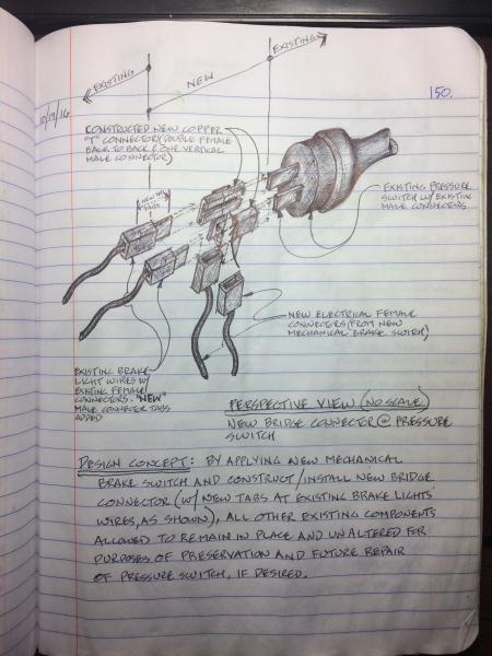

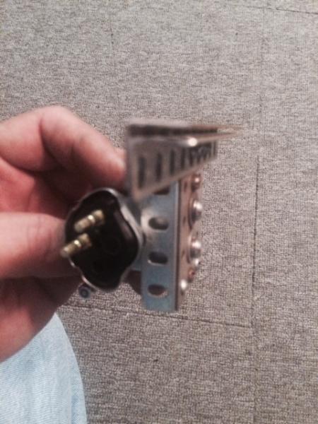

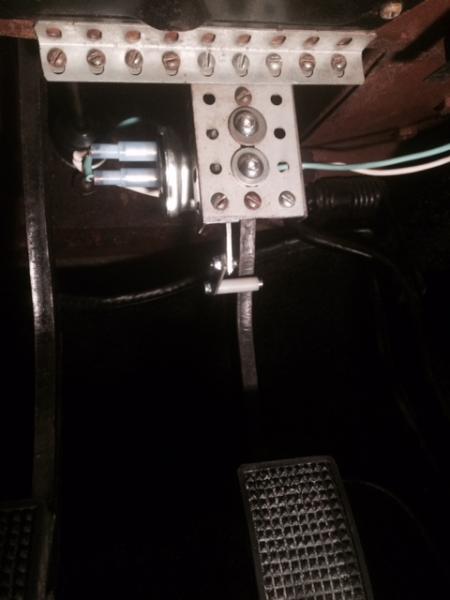

Just in case it turns out to be your pressure switch, which in my case was, (but the reverse since my brake lights would never go on!), I have applied an alternate solution to my BJ8 by installing a mechanical switch, leaving the existing pressure switch in place. In fact, nothing on my car was ever altered, with the help of some miscellaneous pieces from a Gilbert Construction Kit. See sketches and photos. Just offering as an alternate and again, if it is your pressure switch that's the cause (which by the way, I'm not sure if they can be purchased new, but I've learned they can be repaired).
Good Luck.
Paul

As a footnote to this discussion, hydraulic brake light switches often fail when used with DOT-5 brake fluid. Some advocate the use of the Harley-Davidson hydraulic switch as a better, functionally equivalent switch for use with DOT-5. When I experienced this failure on my Mini I chose a path similar to what Paul suggested above. I added a mechanical switch to the pedal box and left the failed hydraulic switch in place.

Suggestion: disconnect both wires from the pressure switch and check across the switch for continuity. If so, it's stuck in the "on" position.
I like the simplicity of using the pedal switch instead of the pressure switch rather than in parallel with it.
The parallel switch system would only work as a backup if the pressure switch was stuck in the "off" position; if stuck "on", the lights would be on all the time whether one had a pedal switch or not.
Have been running a pedal operated switch since 2006. Several pix of the install starting here: https://www.pbase.com/stevegerow/image/70570841

Nice drawings!
