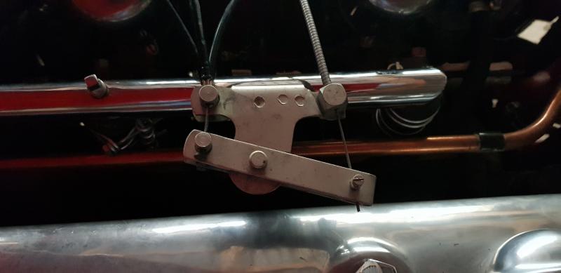

Thanks again everyone. I tried lifting the choke leavers on the carbs manually before cranking the engine and the engine started right away without any hesitation whatsoever, so the problem was obviously that the choke/enricher levers on the carbs were not sufficiently engaged when the choke knob was pulled. Another issue though - on the tricarb there is this device (se pic) on the balancing tube that converts the movement from the choke wire to the wires that go to the carbs. I have adjusted this so that the choke levers on the carbs go down to the adjusters when the knop is pushed all the way in. When I pull the knob all the way out the part of the device where the wires to the carbs is attached simply does not travel far enough to engage the choke sufficiently. I assume I can do as AJ and tighten the cable so the levers on the carbs won't come all the way down but I think this may leave the choke partly engaged when I drive. Another solution would be to drill new holes in the arm on the device so as to increase the travel of the three cables by moving the pivoting point closer to the middle. Any thoughts on this?

I raised the lever to the point just before the jet started to depress and fixed the cable to the lever at that point on each of my carbs (x2 not 3). The lever came up quite a way before the jets moved. I don't believe the choke is open until the jets start to depress. Mine runs ok and I don't have sooty plugs which would indicate the choke is open. I wouldn't mess around with drilling extra holes. You should be able to get it working properly without changing the design.

on my tri-carb i found adjusting the cables on the choke cams just changed how far i could pull the choke out.
the one thing i ran in to was keeping the primary cable in that block. it seems if i pulled the choke knob out and then when i would push the knob in, the cable would slide out of that end. then every time after it was just sliding in and out of the block and not moving the secondary cables as much as they needed to be. i had to make sure it was really secure.
Although it does make sense to move the cams until you feel the pressure of the jet trying to move and fixing the cables just short of there.
