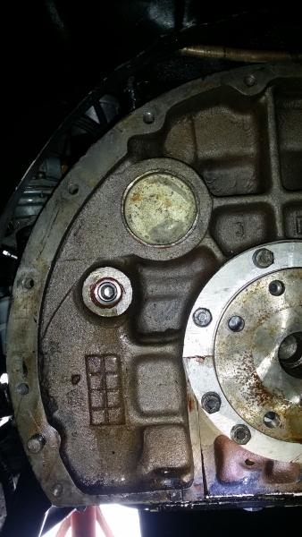

TR4/4A Oil leak from rear of motor.
jimstr4
Here we go again, there's a leak from the rear of the motor.
I've flattened and straightened the sump and used RTV to seal it onto the block.
I've used a Marx seal on the rear of the crank.
I wiped the area in the photo and watched the drop reform, it doesn't come from the sump.
I used a camera probe to look up between the flywheel and I don't think that the rear seal is leaking so I think that it might be the camshaft plug.
The camera probe is too large to look up the that corner of the motor.
The photo is a view of the rear slave cylinder side of the motor.
Looks like the gearbox has to come out yet again.

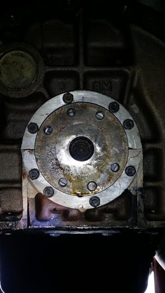

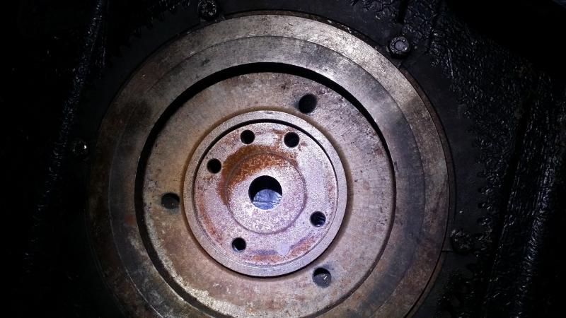

I have attached photos showing that the leak was from the camshaft plug.
The dark crescent shape on the flywheel is oil.
There is oil on the bottom of the rear main flange which doesn't extend up to the bronze bush.
The bronze bush is dry.
I'm assuming that the rear main oil seal isn't leaking.
I'm also assuming that the oil got flicked around from the camshaft plug.
Hmmmmm??????
Any opinions would be helpful.

Graham H
It looks like the camshaft core plug is dry the leak looks to be coming from the oil gallery plug which is at 7 oclock to the camshaft
TomMull
Agree. That plug is under pump pressure and is much more likely to leak.

jimstr4
Thankyou for the replies.
I thought the top one was the oil gallery plug, I got that wrong.
Yes the bottom one at 7oclock is leaking.
Is that a threaded Allen key plug.
Does mine look like a standard plug?

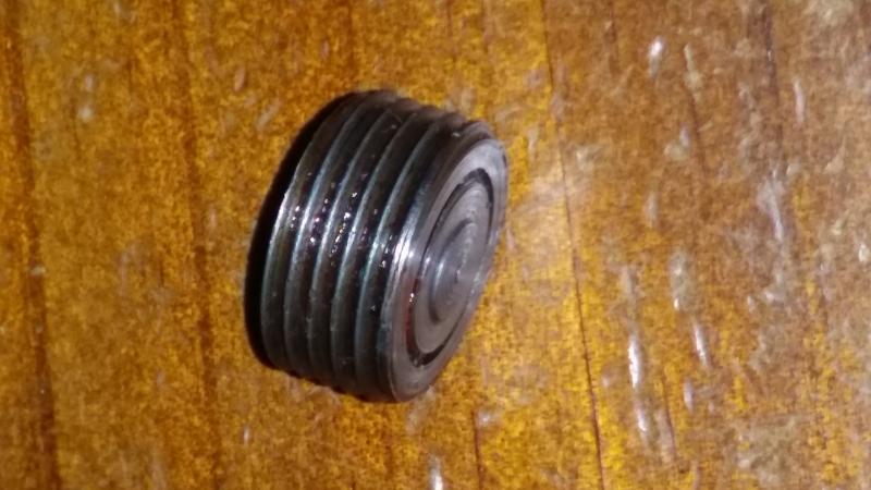

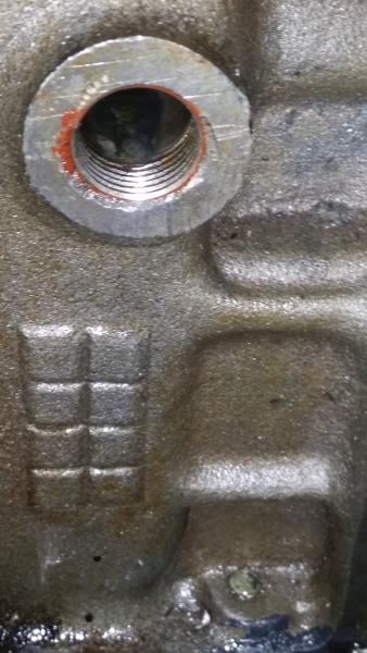

jimstr4
It's a steel plug and the threads look fine.
The gallery threads look a tiny bit scratched but nothing major.

DavidApp
A good quality thread sealer should do the trick. Or the brown shellac type gasket sealer on the threads. Clean the oil out of the gallery threads with solvent on a cotton swab/Q-tip.
David
Graham H
You should be able to re use that plug ,it just needs to be sealed,lock tight or PTF tape. Because its a parallel thread it hasn't got anything to lock onto,the original is a tapered aluminium plug that tightens as you screw it in.
