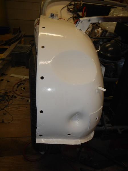

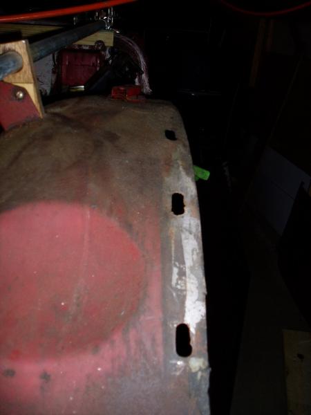

TomMull
I don't think it's all that rare to have both styles on the same car. Mine, TS73117, has the elongated holes on the left and the round ones on the right. I found another on line, Ben's TR3, that is just like mine https://bens-tr3.blogspot.com/ (the picture is toward the end). At any rate, nothing that you need to correct, at least in my opinion.
You'll have to trust me since I couldn't get far enough back to get both wings in one picture.
Tom

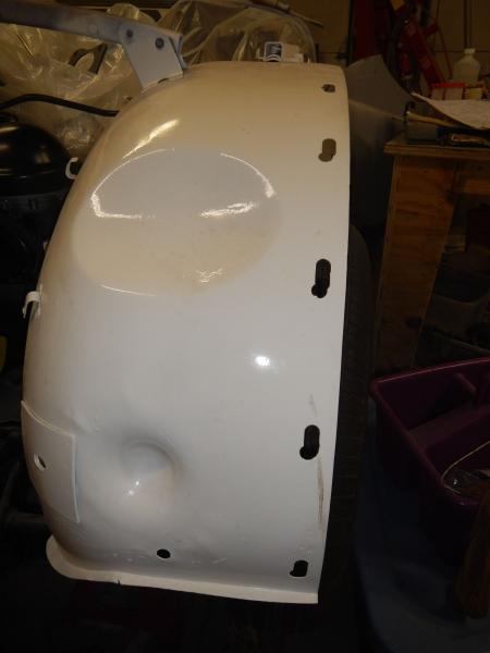

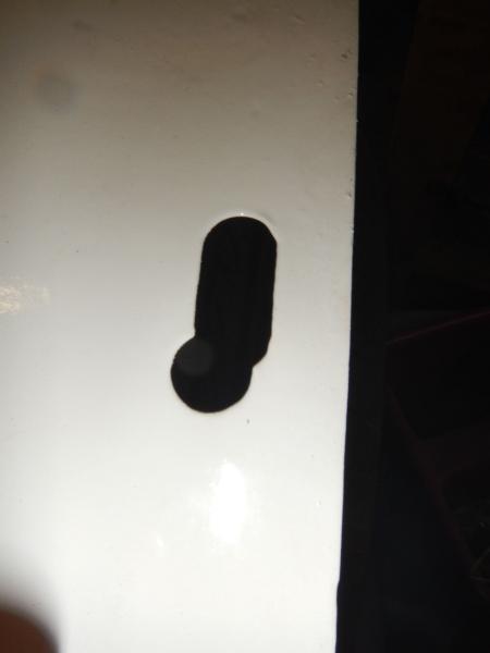

DavidApp
Seems to be a pattern.
Holes on the Right and slots on the right. Looking at my slots you can see the remains of the hole. Do not think it is PO work as it is too regular.
May be to help with body alignment.
David

My TR3 had holes right and slots left. I still tend to think the slots were a later development to aid with alignment. But it’s just a guess on my part.
TomMull
David
I agree that the elongated holes probably aided alignment but why only one side? I wonder if the elongated holes were always on the drivers side? Perhaps the home market RHD cars are reversed.
It would also seem that your inner wing was punched twice and slightly out of alignment at that. Seems unlikely that they were drilled at a later date but possible, I suppose.

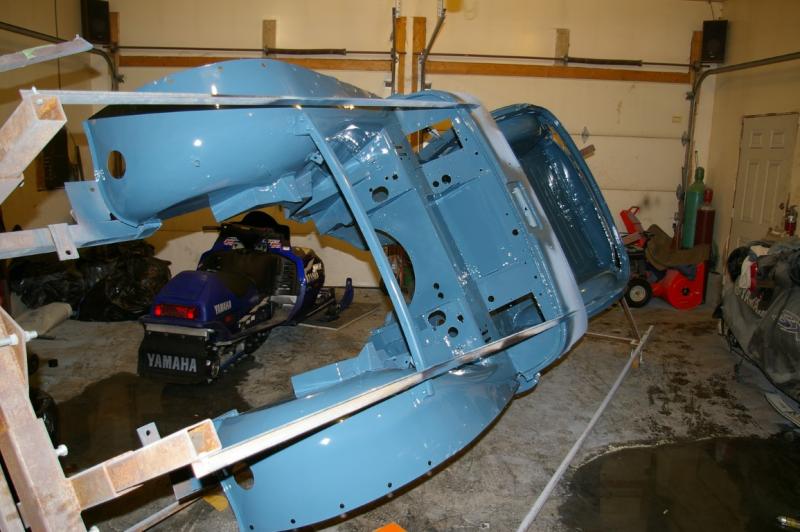

mgedit
Took a while but I finally found a picture of my 56 during restoration as a point of comparison. Fairly early car, and holes on both sides are round. Cheers, Mike
TomMull
Confirms John's statement earlier. I'm guessing the longer holes were introduce to speed up production. Still curious about why only one side.
Nice looking body. Is that powder blue?
