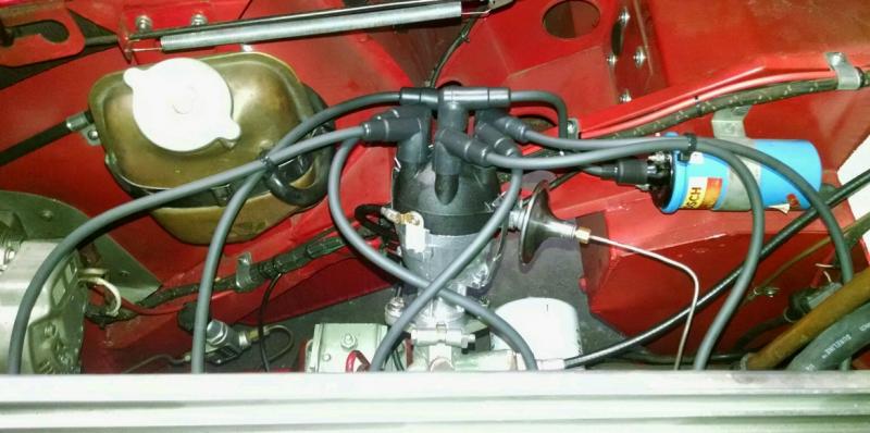

Received my Pertronix 7mm stealth wires. Built this setup from their 8 cyl kit.
This is my Schlemmer-tweaked 22D distributor with top-entry Lucas cap. He convinced me to go back to points & condenser:

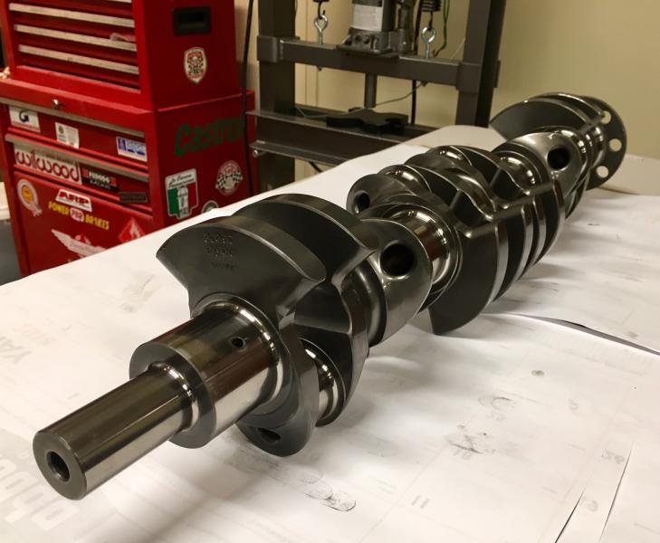

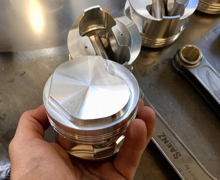

Ditto for me....I've raced with both the Pertronix Ignitor and currently Ingnitor II. Jeff built my race distributor years ago base on a Lucus Jaguar D type unit. I've had issues with coils in the past and I'm currently upgrade my system with the Pertronix Flame Thrower HP coil and new Digital HP System. My new race motor willing living at 7000 rpm.
