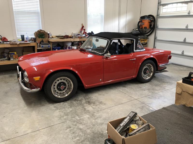

Here's a quick pic of our TR6
JPSmit
lovely! thanks for sharing
