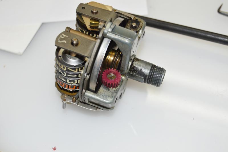

My son got a 3D printer about a month ago, and have had him make me a few things, but yesterday, I had him make something for the TR3. One of the fiber odometer gears packed it in awhile ago, so I thought that we should be able to make one. I used the TinkerCad free program that actually has six different gear shapers, one of them pretty complex that can do helix's and bevels. We actually made a helix gear for a small gear motor I have that had a stripped fiber gear. Anyway, the gear for the odometer took a couple of tries to get on the money, but it works just fine. I had to make it about 1mm higher that the original, but only because it seemed to print the profile better.
These are more than just toys, they can actually produce useful stuff.

Yeah, you need something. Original specs, or in this case, having the original (less a couple of teeth), I was able to get measurements. Even then, I had to tweak them in the program to get the gear to fit perfectly.
I'm just getting my feet wet and have only made a few simple parts, but I can see, that very complex stuff from even the free program that I have been using. The program that my son has is a lot more sophisticated, but it also has a steeper learning curve. I need simple.

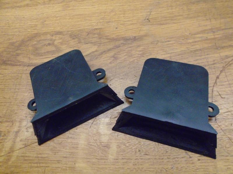

You're right, but often a broken or worn out part is good enough to get measurements from. My TR6 seat belt parkers were a good example:
https://bullfire.net/TR6/TR6-83/TR6-83.html#Parker
Even with a totally absent part, you could often design something that will work.
