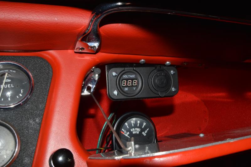

martx-5
I also mounted it in the glove box along with a voltmeter in the same bracket. You have to have the glove box door open to use it, but I don't find that a problem. Besides, if I'm using the GPS, it's usually stuffed in the glove box also.

When I bought my car in 1976 it was mounted where mart-5 has that black button in the lower left of the pic. Don't know if it was a factory install there or if they even did cigarette lighters as OEM. When I restored the car I covered it up, now I'm looking to do the same for my phone chargers. On the complete opposite side I installed the washer squirter switch. I was afraid to remount the cigarette lighter in it's original spot and make the dash look too crowed.
