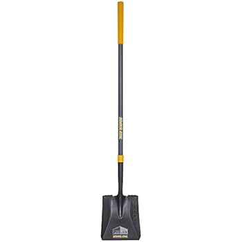

Let’s take a step back and try to get a little perspective on what you’re trying to accomplish.
Basically, you’re trying to smooth out your paint to the point where surface imperfections are imperceptible. You have a variety of tools, chemical and mechanical, of varying capabilities at your disposal. As with any tool, you’ll get the best results by matching the tool and technique to the task at hand. Some of those tools will remove larger imperfections quickly but leave telltale imperfections of their own. Others can remove very small imperfections.
This analogy may not be exactly to scale mathematically, but I think you’ll get the idea:
Think of your paint as if it were your garden. And you want it really flat and smooth so you can install a putting green. You’ve brought in loads of new, clean soil and it’s piled up and lumpy. You need to grade it out.
Blemishes like runs and dust nibs are like dirt piles about the size of your house. You could theoretically smooth them out with one of these.
But really, you should probably use one of these:
or
C10337180
These are the equivalent of say #800 sandpaper.
