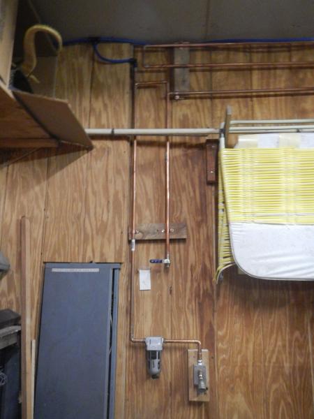

Filter for water or crud?
I did the John water trap system with lengths of copper pipe to help condense the water vapor. Works well.
David

Your’s is much neater than my pipe work, David. That gives me goose bumps looking at yours!

David or John. Can one of you explain or show me a diagram of the "John water trap system" ? I have a water trap, but it also can get very humid in CT. I'm looking at the picture, but can't see all the piping. Just a pencil scetch would be appreciated.
Thanks, Scot
ChrisTR2TR4
up at the top of the photo, you'll see some copper pipe going back and forth. It cools the air in the pipe and allows some of the moisture to condense and flow down to the vertical pipes below. I use a coil of copper pipe zip tied to an old window fan with similar results.
CJD
Hey Scot,
It’s not my system at all, but just a down-sized way of following good compressed air practices. In general, you set up your piping as follows:
1. Use copper, mainly for best heat transfer without getting corrosion in the pipes. Use the largest diameter pipe, to slow the air flow speed, and therebye reduce the tendency of the air to “blow” the condensed water back into suspension.
2. For each run of piping, you must have a slope in the direction of the air flow, so as the water condenses out of the hot air, it will drain forward and downward.
3. If you must have a low spot, then include a “T” with a pipe going straight down and a valve to drain the water which will accumulate there. ANY low spot will accumulate water, so you must have a way to get it out of the main flow.
4. For each fitting you plan to use to tap into the system, use a “T” that takes the pipe upward!! That way the condensed water will stay down, and mostly air will come out of your tap.
5. At the end of each run of pipe, have a down pipe with a drain valve. Again, the final tap should initially go up, to avoid water following the air.
That’s really it! Chris’ has a great idea with a fan for a heat exchanger, but you must design the cooling coil to have no low spots. In a low spot water will accumulate and then “spit” down the pipe in large clumps, eventually overwhelming your separators. The coil cooler would have to zig-zag downward with a drain at the bottom, or coil downward to a single low spot at the bottom...and again a drain valve there. The goal would be to have the air at the final tap right at ambient temp...to minimize condensation. Unfortunately, even if you could reach ambient temp, when you open the tap the pressure and temp fall in the lines and more water will condense...but at least it will be a minimum.
That’s it. Not really a system, but just “best practice” to eliminate water for painting or sand blasting.
Oh...on the final tap, where I plan to access the air for painting, I use double filter/separators as a final chance to eliminate water. And even here in TX, with 40% humidity max, I still get water in the final taps.
David pretty much followed the best practice perfectly! After reading this, you should be able to pick out of his pic the reason for each seemingly redundant down-pipe.

Thanks Chris, and thank you John. The picture makes perfect sense now. John, sorry you had to type so much !

I should have typed more. 😁 my fan/coil assy is in the compressor room and there's a good 12 ft of vertical run and 3 drops between that and the final dryer. Last thing I want is water running through the gun.
