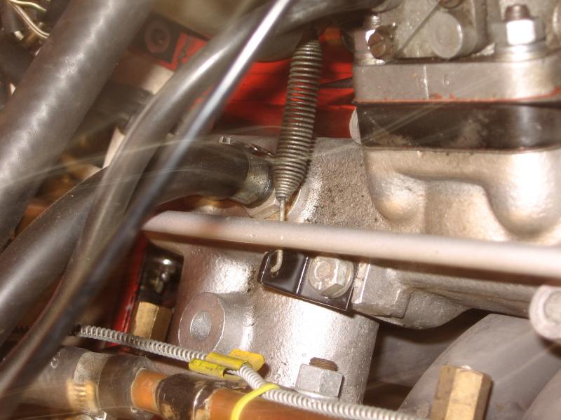

AJ, I have HD8 carbs on my BJ7. Years ago I would adjust the carbs exactly as the manual discribes. But in doing that I could not get the idle speed up around 800 or 900 rpms unless i enrichened the jets and it sooted up. In the last couple of tune ups, which has been over about a 5 year period, I have started to crack open the slow run screws just a wee bit. I can achieve a better idle speed this way and i do not have any sooting. I also have removed the hose from the valve cover "T" fitting to the rear carb. I have used an open 2" K & N filter on the "T" fittling. I have not had to touch my carbs between tune ups at all.

AJ, My principle was correct but I worded it wrong. On the HD8 carbs the book tells you to keep the throttle plates closed and to adjust idle speed with the slow run screws. I finally decided to crack the throttle plates a wee bit and adjust the idle speed with the slow run screws.
