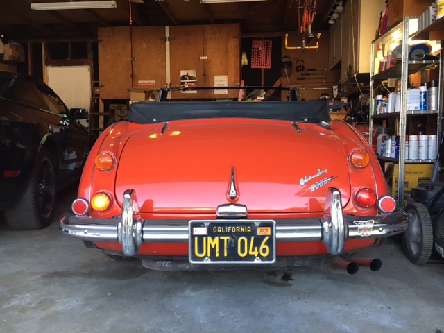

The speedometer and tachometer have colored lenses for bright headlights (blue) and charging (red); at least on my BJ8. I originally replaced all the incandescent bulbs with LED, and they all worked as expected, but came across an admonishment in the Moss Motors catalog that LED bulbs should not be used in the charging circuit. Although I never had an issue using an LED in the charging circuit I bowed to the catalog and other sources--including someone on this forum (Richard M?) who is knowledgeable--and put the incandescent bulb back in (I forget the explanation). While you're at it, consider a safety upgrade for our wimpy running/brake lights:
https://litezupp.com/epages/ac0e8ca...ab-e6c1-4d6b-ab90-9213bdc3f061/Products/L57RP

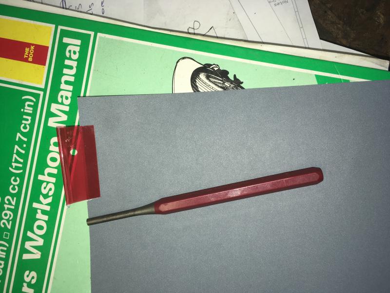

someone on this forum helped me with the lense issue. i had one but the other one was gone. take a red folder tab and punch a hole with a drift. then just a dab of glue and stick it in. quick and cheap. looks like the other one i found that was in my speedo.
i converted to alternator but when my alt stopped charging i could see the bulb pretty easily.

Thanks Drone Dog - excellent idea. I have a set of drift punches, one of which should certainly be the right size, so I will try that.
Moss says their exterior LEDs 'require negative ground,' so I assume the flasher is for negative ground cars only. The resistor kit should work with positive ground--resistors don't care which way electrons flow--and the LiteZupp people supply positive ground exterior LEDs (they're Triumph enthusiasts).

would you still need an electronic flasher if you leave your front bulbs alone? they should trigger the normal flasher shouldn't they?
Can't say for sure--I've only put LEDs in my BJ8's running/brake sockets; flashers are a separate circuit--but I'd assume you'd need either the electronic flasher or the resistors as each side's front and rear turn signals are on the same circuit. You could call the Moss people and ask.

I don't think they will draw enough current. One bulb recently failed and the result was faster blinking and that the indicator lamp didn't work, so I assume that the result would be the same with an LED. The resistors are easy to install though.
Jack T
When i put LEDs in my BT7's brake / turn signals, one side worked fine without a resistor, the other didn't. Easy to install at the flasher relay on the inner fender.
