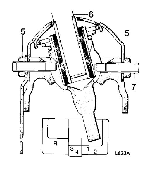

Here's a nice photo I just found. Item 31 is a TR4 lever, Item 32 is TR6. Items 35, 36 and 37 are the cover and spring I mentioned.
PeterK
And #38 is pretty important to keep the lever attached to the gearbox top cover.

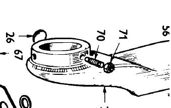

Strange you should mention that; TR6 doesn't have 38. There is no hole through the ball, just slots where two guide pins (one on each side) ride to keep it lined up. Item 70 (plus locknut 71) in this drawing. (Later, it changed to a special bolt that didn't need a locknut; but some of them had a 2nd threaded section and a nut for a support brace.)
PeterK
That's right I think my 4A had two shorter bolts on the edges also but things get swapped between cars and I might be confusing it with the HVDA shifter housing.
