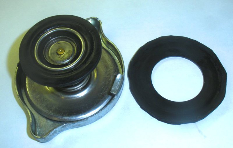

It'll work. You add a thin gasket inside of your radiator cap so when the car cools down, it pulls the coolant back into the radiator. You'd also need a vent hole in the bottle cap. Make sure your hose is long enough to reach the bottom of the bottle. Add a little coolant there so it doesn't suck air.

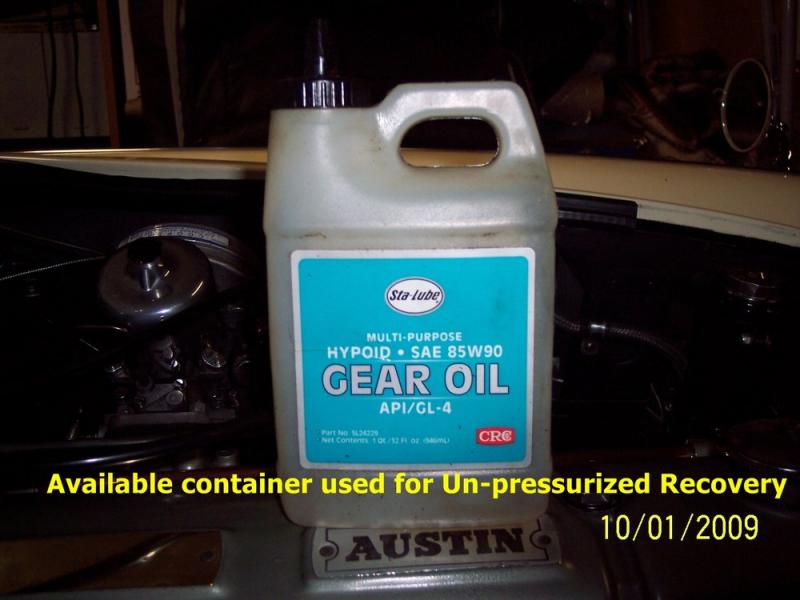

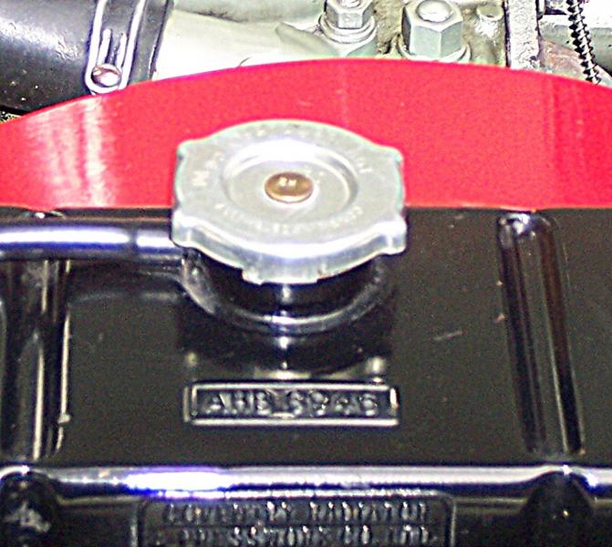

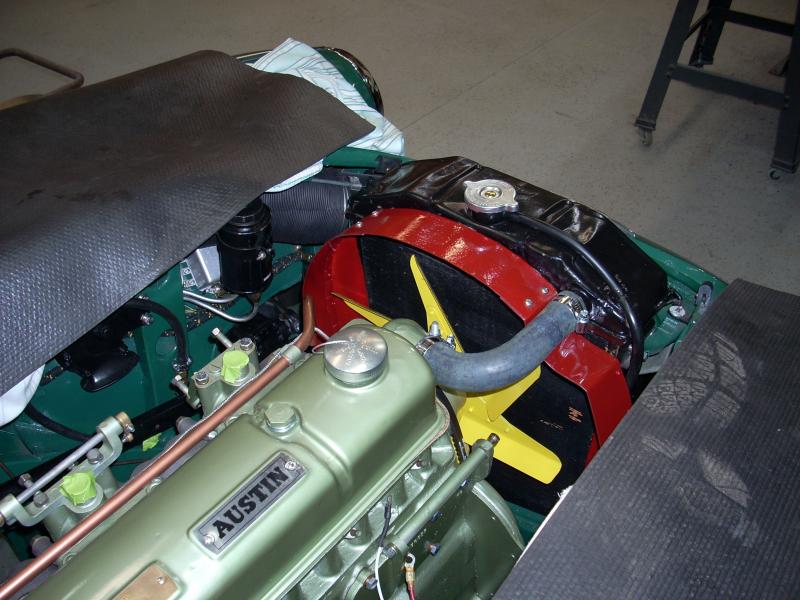

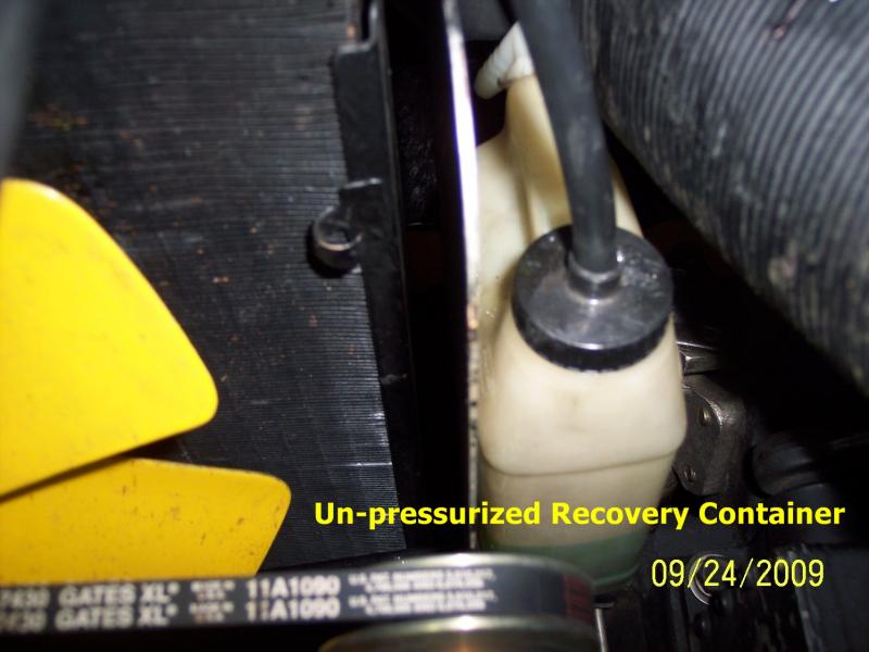

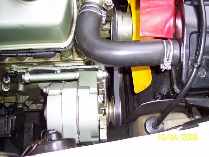

Hi All,
Although a pressurized overflow bottle cam on my TR7. I prefer the non-pressurized approach for my Healey. The non-pressurized system required the replacement of the original radiator cap with a Balkamp 703-1411 purchased at NAPA which allows for fluid recovery. Since the tank is not pressurized, any 2 qt, capped container will do. For me, my selection was an empty gear oil container that fit inconspicuously on a small platform created between the radiator and fender and could be easily removed. Rerouting the overflow hose through a hole made in the overflow container cap was the last activity for this installation. It has served well over a number of years with no further consideration.
100_0267.jpg mini-Recovery Container.jpg Coolant Recovery.jpg 100_0265[1].jpg
Simple, effective, and inexpensive,

do you think the washer bottle is big enough? my guess is it holds about 24-30 oz of fluid. smaller than the one on my TR6 but it is not like the TR empties or fills the bottle when in use.
RAC68
I would say "Try it". There will be a time that more liquid may be expelled from the radiator and lost to the ground. However, hopefully this will not be often. If this occurs too often, just select a little bigger bottle from the recycling bin in the kitchen or you can also select a more conventional container from any of the auto parts suppliers. Either way, your choice is endless and your cost is nothing to minimal.

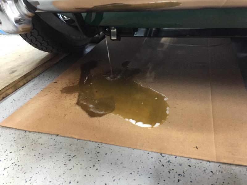

the radiator cap is new also. now i think i had put too much coolant in it. so i epxect a little to blow out. after i shut the car off each time today, i would get coolant thru the overflow tube.
after the third run and the engine shut off. of course it gets hotter then and i can hear the coolant going thru the cap. see pic:
again this could be from having too much fluid in the radiator. i think i filled it once to right below the neck figuring it would equal itself out.

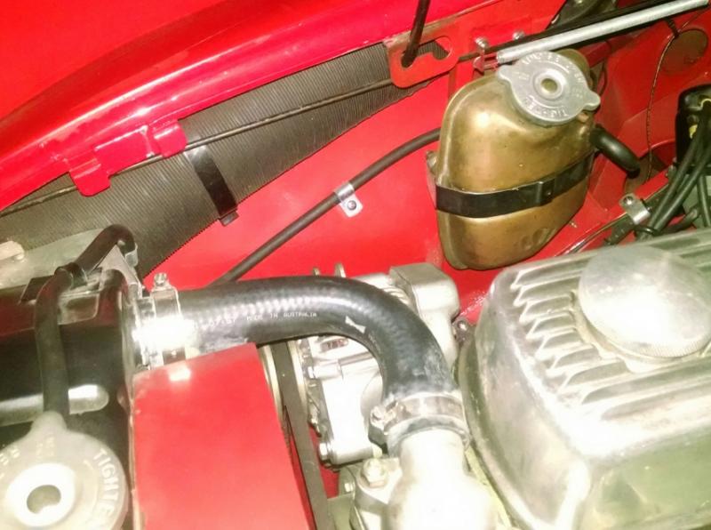

I use an old (brass?) MG overflow container. Think I stole the idea from Randy Forbes. Works well.
LOL!
This is off a >'68 Midget, but they were also fitted to late MGBs too, and probably some Triumphs. I found this NOS one at an All British car show, for about $40.00 LESS than the guy a few tables down was selling reproduction ones! It WORKS, as the siphon tube reaches near the bottom, so as the radiator cools down, it pulls back any coolant it had pushed out while heating up__no more puddles on the ground! The overflow can must be vented to atmoshere at all times though, or it won't work; I use a modified radiator cap that's no longer "pressurized."
