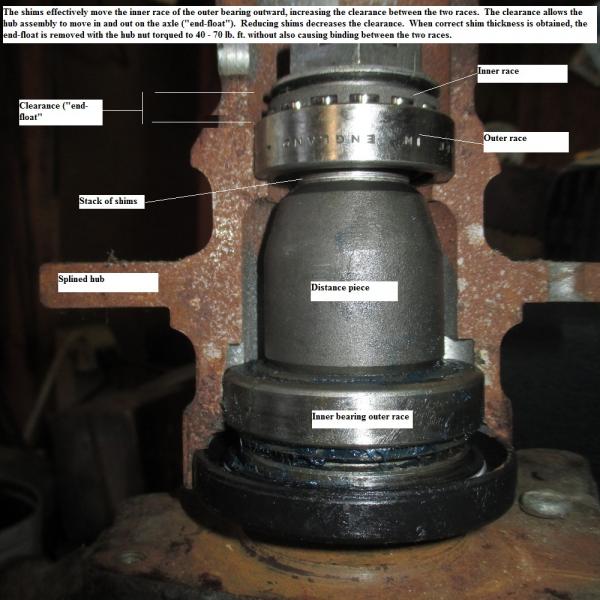

BJ8Healeys
Correct:
Because what you are actually doing is stiffening the axel by causing the distance piece to perform like a loaded column---that's Why--.:friendly_wink:
Sorry, but that is an incorrect statement, Keoke, if you're suggesting the distance piece helps strengthen the axle. That is an idea that comes up in every discussion of the distance piece. The distance piece's (plus shims) only function is to provide a way to get the proper pre-load on the bearings. It has nothing to do with strengthening the axle. The torque on the nut does not significantly increase the tensile stress on the axle. If it did load the axle significantly in tension, that would actually promote cracking of the axle on the bottom side at the hub because the tensile stresses in the radius at the base of the axle would be added to the upbending stresses there that the axle normally sees in operation.
