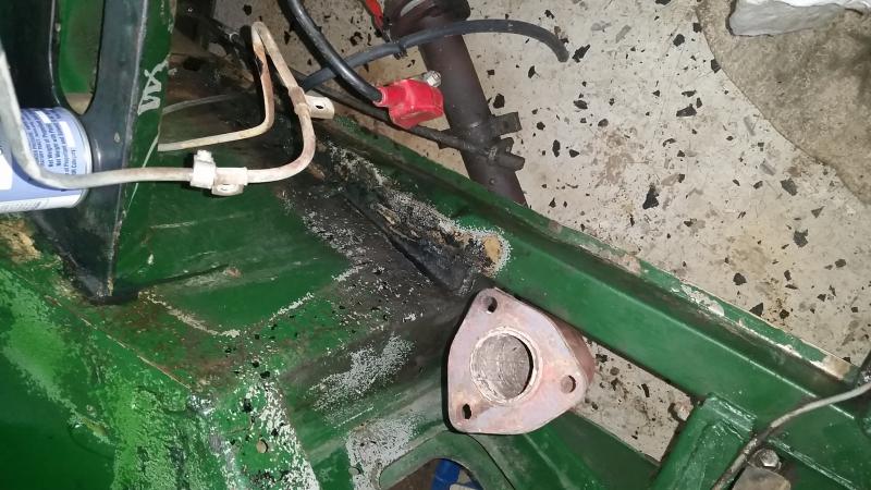

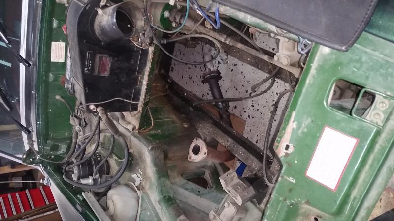

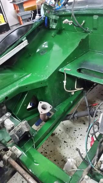

Bob Buxbaum
Progress

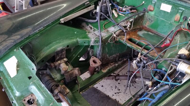

Bob Buxbaum
I have another picture, it's an "after" picture.
nomad
Wow, I was not aware that the later midgets were that much different under the bonnet. Looks like a pretty solid car.

Bob Buxbaum
Being a garage kept 15,000 mile car, it is absolutely rust free (except for some light surface stuff in the engine compartment that is been treated). A previous owner had the car resprayed (quite nicely, too) to a darker shade, but outside only. The convertible top is original, and in excellent shape, but has "shrunk" a bit. I FINALLY got the top attached at the windshield and snaps, but that was a bit of a war. So, other than the engine issues (in another thread), various hydraulic issues exist, but are simple fixes. Assuming the block is good, it could be running again next week.
