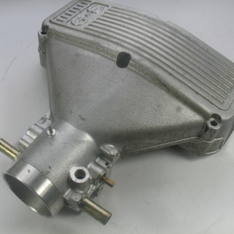

    If it's got a 3.9 and is running FI then it probably has this plenum

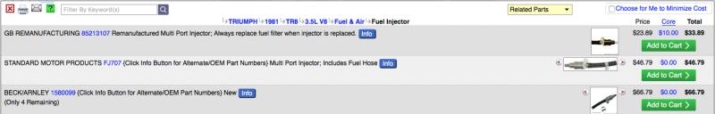

    Quote Originally Posted by NicH2Olas View Post
    I'm currently in the process of replacing my FI with a 4 barrel unit. The FI system had been fairly reliable, but recently became prone to engine flooding. Being old, the plastic body of the injector would crack and let fuel seep into the engine when it wasn't running. I replaced one injector originally, but then a year later a second one failed the same way. Given that there are 9 injectors (8 cyls plus one cold start in the the plenum), and they were more than $100 each, I decided to go for the 4 barrel conversion.
    Hi Nick,
    I don't know what sources you have in Canada, but you should be able to get new injectors for much less than $100 each.
    -Darrell
