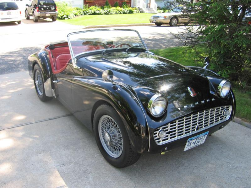

I have the same wires on my car...72 spoke, 15x5.5 shod with 185/70-15 tires. No clearance issues. Also, wheel circumference is very close to original 165/80-15. Less than 1% smaller.

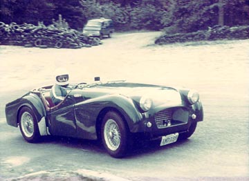

Same 5.5" wheels (TR-6 spec) on my 54 TR-2
