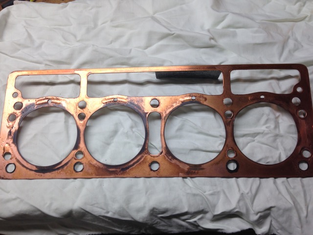

If my photo works its what the gasket looks like.

Sure looks to me like you had leakage around the other cylinders. Seeing that, I would definitely do all 4.
