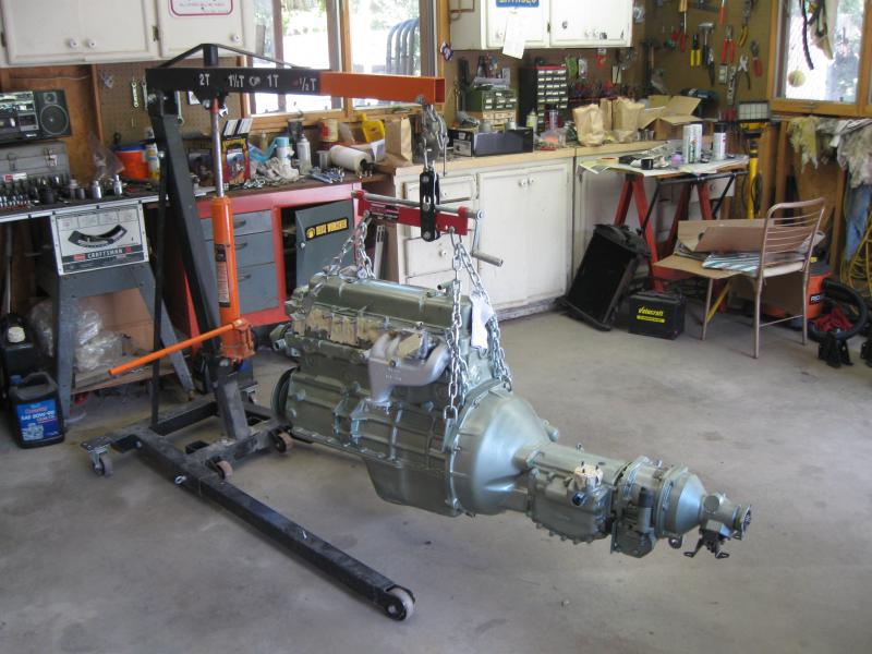

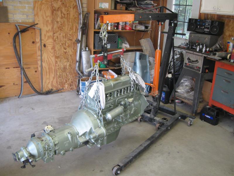

I used that plate to lift the whole driveline . The angle was too steep but using a combination of my hoist and a cumalong up to a 2X8 across the runways with the car below the hoist ramps I was able to raise lower the hoist and cumalong to create the perfect angle to get the driveline into the engine bay on my own and line everything up without busting a knuckle etc .
It was perfect
dougie
I've always used this system. The motor seems to come out of my race car every year, much to my chagrin.....

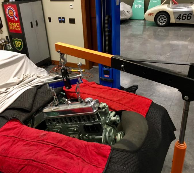

Here are a few picture from my installation.
Keith

You have a tri-carb right? You must attach the rear exhaust manifold BEFORE installing the engine. It's pretty much impossible to attach (or detach) after the engine is installed. Note that it is attached already on my engine as we install the engine.
I had no trouble with the chains hitting the firewall, and the four attachment points gave good control while tilting the engine. The initial angle is pretty steep, and it's a very tight fit. You have to move it back, then level and lower it, then move it back, then level and lower it---about 10 times before you can clear the front cowling and lower it into position.
Keith
