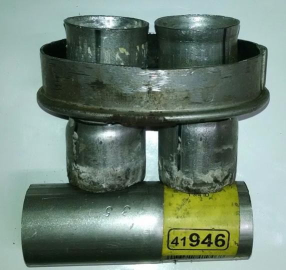

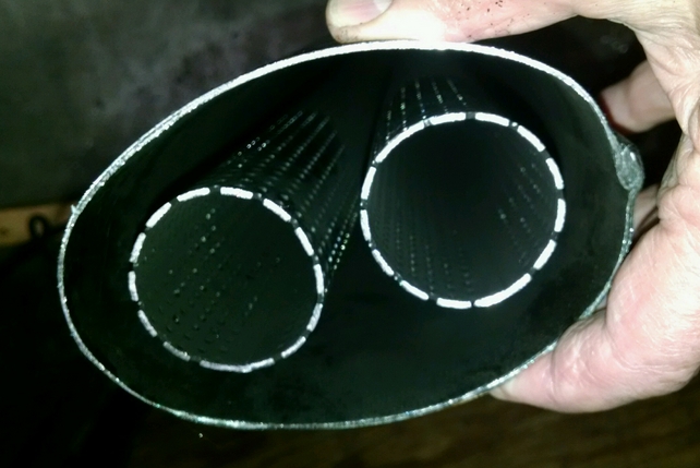

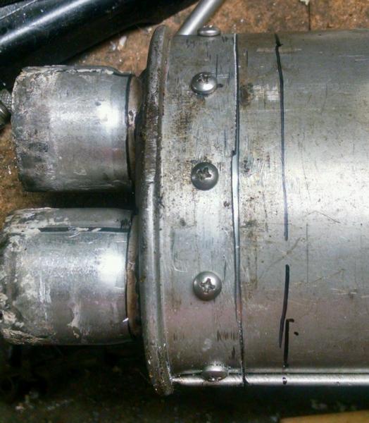

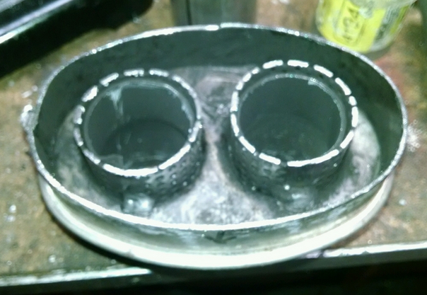

Current build status - building the muffler while awaiting the Acousta-Fil from Demon Tweeks.
I used reducers from the auto parts store as slightly-bell-mouthed connectors for the internal perforated tubes.
The internal locator piece is 1-1/2" x 1/16" aluminum from the hardware store. Screws are 10-32 x 3/8" SS threaded into the aluminum.
I staked the bell connectors in as I don't yet have welding.
Tomorrow will fit more screws into muffler body.
Muffler ends were enlarged to fit header connectors.
I don't think the aluminum will stand up to the temperature, leaving the screws to fall out.
Steve, I think it's about time for you to step up to a MIG welder (just think of what you can accomplish then!)! Check the classifieds (Craig's list, ebay) for a good used Miller, Lincoln, or even Century.
If you're dead-set on screws, to be able to have future access, change out the aluminum to steel__and a little thicker to get another thread or two in there wouldn't hurt either.
steveg
steveg
When/if the aluminum poops out, will switch to stainless sheet - for which I need to find a source.
Concerned about regular steel corroding away. Whatever I build needs to be able to be disassembled to be repacked.
Addendum: Read up on aluminum melting point; bought some SS sheet and will redo and follow up.
