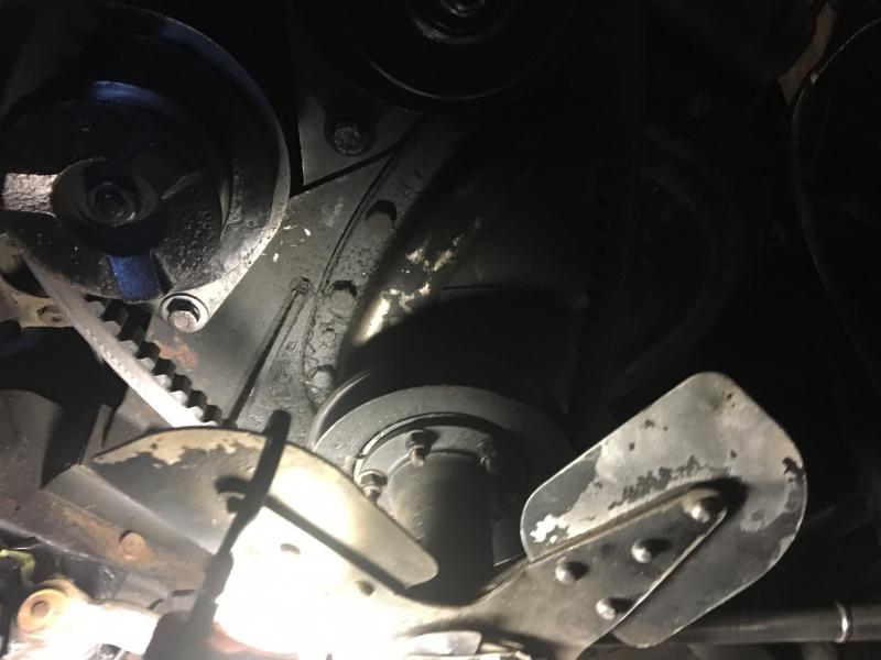

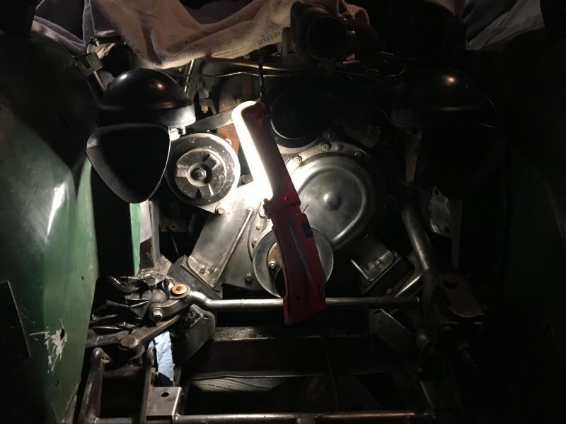

Decided to do a bit more work on the front engine compartment with the valence and radiator out. The previous owner had brush painted the engine, suspension and frame w/o removing rust. It is a California car so rust was not crazy but still a pain in the B&*% removing with Naval Jelly. Here is a picture as it sits currently... almost ready to be painted.
