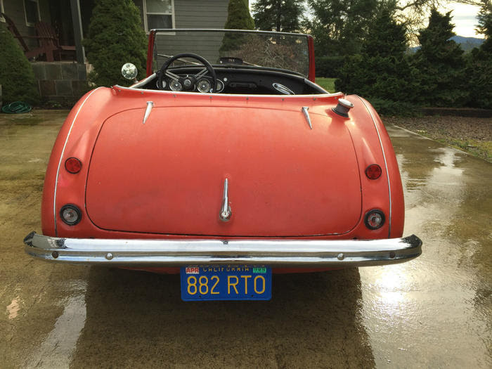

    Good mornings, thanks both for the reply and your site (great resource).
    As an early Longbridge car that means pre-1957 so I think I am good there.
    How big of a deal is the replacement engine on values and eligibility? I use my cars so not overly concerned about getting dinged at a show by a judge but want to be eyes open about it. She is a moderate restoration so no way around it consuming a fair amount of money and would be keen on everyone's thoughts as to impact on value.
    I doubt that the touring events I am planning on running will car about the replacement engine but now would be the time to ask about that too.
    Should I start a new thread on body work questions or just keep going here?
    Thanks for the help and coaching!

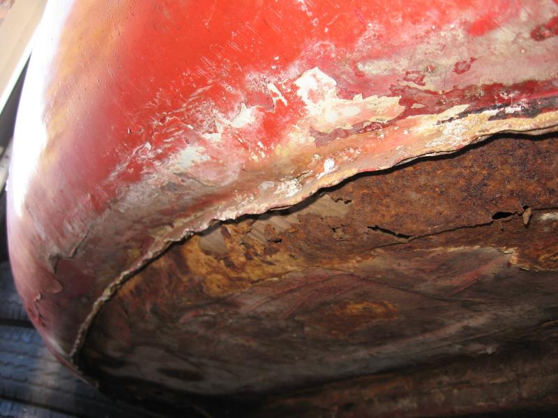

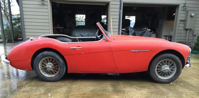

  19. #19

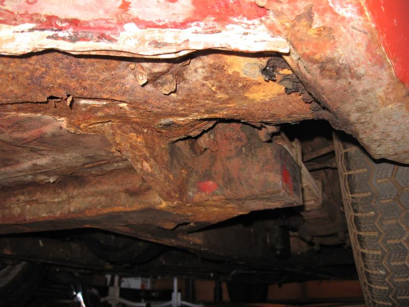

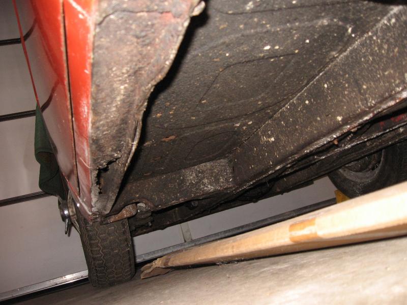

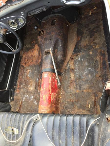

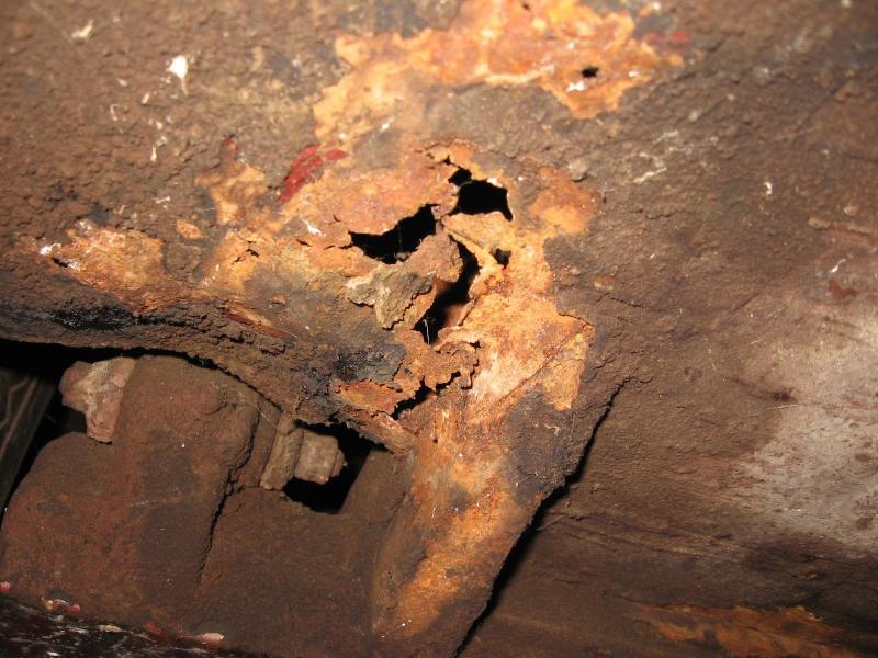

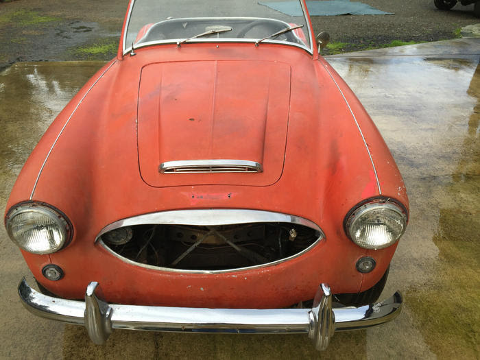

    Here is the worst of it. I am handy with a MIG so some panel replacement doesn't scare me, maybe it should!
    IF the frame is OK can I just cut back to good metal and let these panels in?
    Gaps look pretty good good to me - but what do I know;
    Attached Images Attached Images

    "IF the frame is OK can I just cut back to good metal and let these panels in?"
    Yep. The only problem I can see is at the rear, near the rear spring shackles (the brackets that go up and support the rear shroud at the bottom of the boot opening). That rust could be pretty deep and those brackets are (somewhat) structural. Clean that area up real good and decide if there's enough good metal, or if you need to patch some in. The rear shroud is aluminum, and attached with rivets to the boot pan. It appears somebody went after the rivets with a chisel, but I think you can straighten it out. Side note, if you're looking for originality: the bottom lip, where the shroud is riveted to the boot pan, should be painted flat black with a brush; sometimes, that's not done on even 'concours grade' cars.
    Gaps on the bonnet and boot lid look excellent, which sometimes isn't the case (those gaps on both my BJ8 and BN2 aren't nearly as good). The real test is the door gaps; sides and bottom (need photos ). When you fit the outer rockers be sure you have wings (fenders) and doors fitted before welding them up. Most of the original welds were spot- (rockers) or lap-welds; rosette welds are a good approximation for the spot welds. One of these will make the rosette welding a lot easier (and fun!):
    https://tinyurl.com/yax9s6c6
    The bottom of the sides of these cars should have a very slight, graceful, upward curve. Some repop rockers--well, any that aren't made by Kilmartin--have a straight bottom edge that looks just slightly 'off.' The rear wheel well opening has a wire bead, which the wing metal is wrapped around (again, AFAIK, only Kilmartin sells panels with that bead). A mistake that's often made with the dogleg repairs is to have the rear of the dogleg sticking out instead of following the curve. These look like 'spurs,' and you see that on some otherwise well-restored cars.
