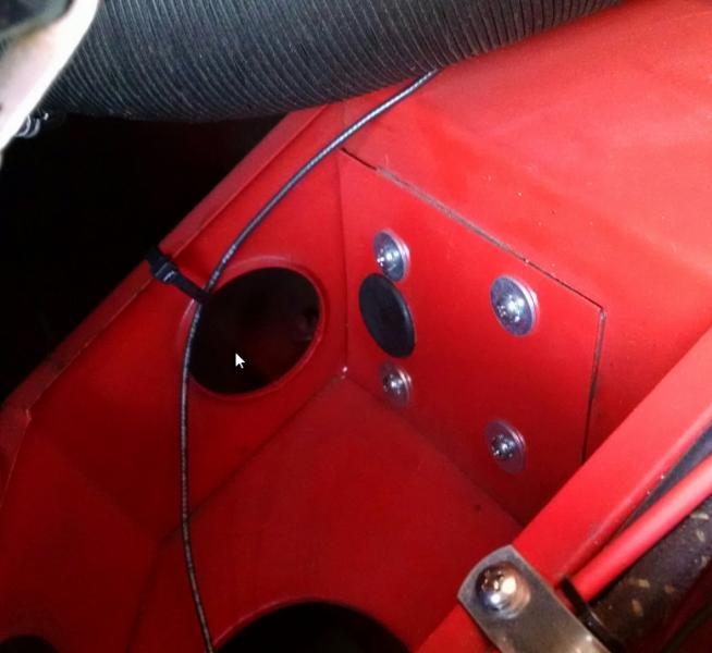

    What about the roof of the passenger footwell inside the cabin? Run the wires through the rt side throttle shaft hole or the RHD master cylinder blanking plate.
    There should be 2 small holes on either side of a large hole - mirrors those used by where your throttle pedal shaft passes through the driver's side footwell. Probably these are blanked with a rubber plug for the large one and maybe screws for the smaller ones.
    Also consider a hole in the blanking plate for the RHD master cylinder location.

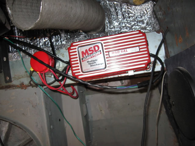

    Will the wiring reach inside the car? My MSD is hung where you'd likely have your heater, but there's still lots of room under there, and a bit nicer environment than the engine compartment or outside of the footwell.
    I only left the coil out there

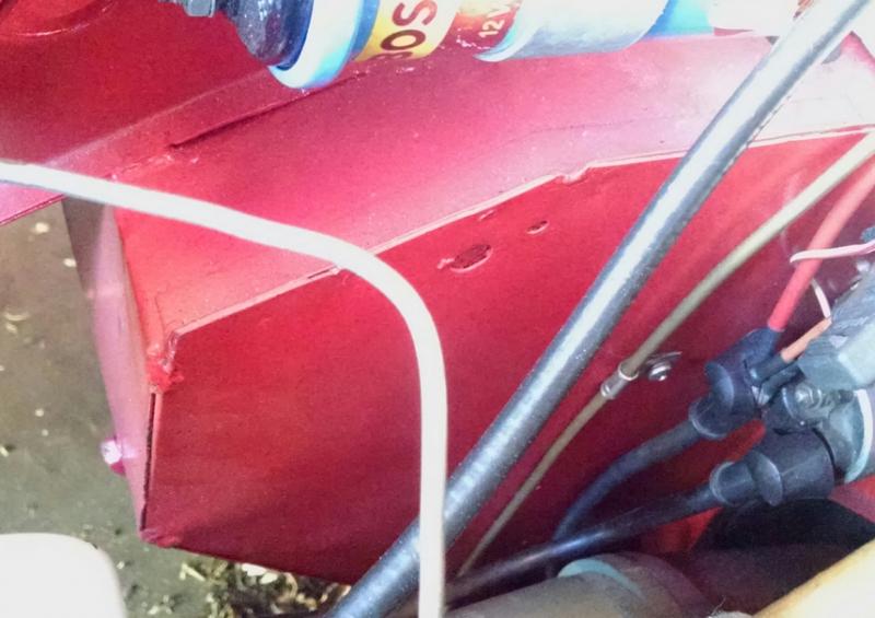

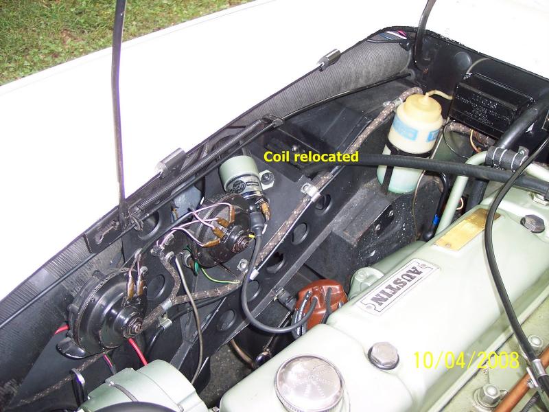

    Hi Bill,
    I have been using a Crane Electronic Ignition for quite a while and installed it on the passenger foot well (where MCs would be mounted on RT Hand drive cars). As the picture shows, I have also installed an Alternator and moved my Ignition Coil to the frame in front of the Crane. In the picture, the Crane is behind the Ignition Coil Label and is painted black to somewhat hide the unit.

    Can't tell by your post whether you're planning on mounting it inside the cockpit or on the engine compartment side. I'd advise against mounting it on the footwell on the engine compartment side as you'll get a lot of water spray that can leak in and short out the whole thing. I mounted my MSD box on the heater rail on the passenger side and I use a piece of hardura with velcro on the back to cover the whole thing. That location, while nice and dry, did prevent me from mounting the package tray, however. which I didn't find to be a great loss.

    Hi Bill,
    I have had my Crane Ignition mounted in the area previously pictured (upper section of the passenger foot well under the engine shroud) and driven in rain downpours with no problems. The Crane unit is sealed and only somewhat vulnerable where the wires from the distributor are plugged to the wires form the unit. I had applied dielectric grease to seal the connection and all has performed flawlessly.
