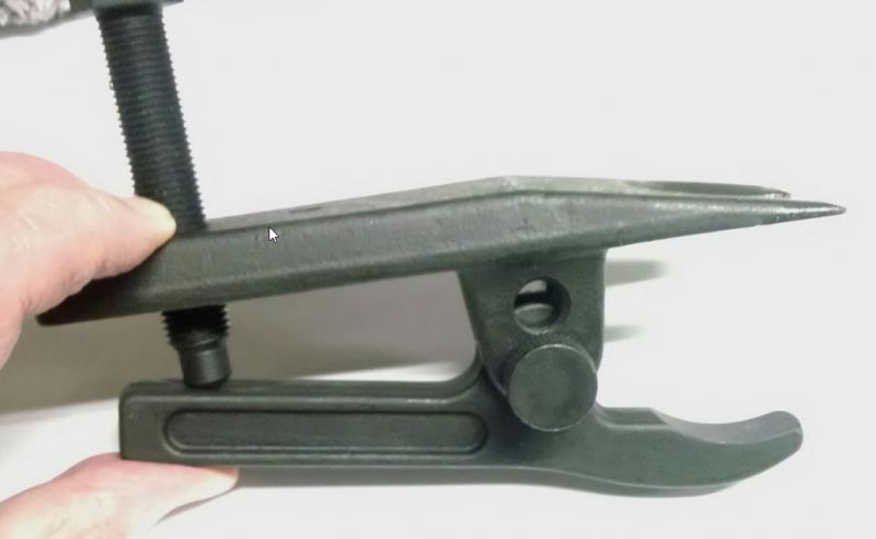

    Bob - I have this HF ball joint puller and would need to grind the opening larger to fit around the rocker shaft - is this the puller you used?

    I misidentified it; it's actually more purpose-built:
    https://www.harborfreight.com/tie-ro...ler-62708.html
    I had to grind the opening larger and sharper to fit over the 'knuckle' of the pittman arm. Note these cheapies all have a fault: the fine thread on the screw usually strips the aluminum body eventually.

    Quote Originally Posted by Bob_Spidell View Post
    Bob - thanks for the followup. I've got one of these, too. It Would work if box detached and rotated per above. If I grind the ball joint tool above enough to fit around the rocker shaft, it will fit without unmounting the box.
