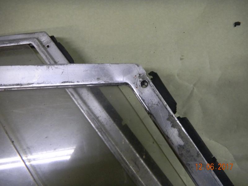

    here is a picture of what i am talking about. the front curtain is the inside and the back one shows the outside.DSCN0390.jpg

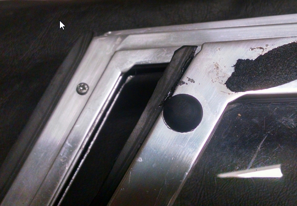

    Re: bt7 side curtains
    My 10-year-old Moss repros look like this:

    steve
    that is it. so does the screw go all the way in to the bumper? i know the hole on the inside of mine is larger than the butt on the bumpers. so it would not stay in unless i glue it or the srew holds it.

    Quote Originally Posted by Drone Dog View Post
    steve
    There's no reason for the screw except to secure the bumper. I'm not inclined to take mine apart as they might self-destruct, I have no replacements and Moss doesn't list them.
