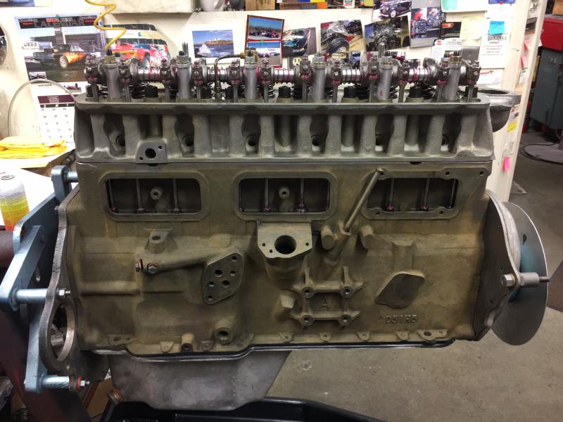

    They're not hard, I grease them first (white lithium) so they won't want to bunch up. They will stick out at the pan rail some, but are easily cut with a sharp single-edge razor blade.
    Make sure your end bearing caps are free from nicks and burrs, that may impede their progress.
    I don't use any sealant, until I am putting on the oil pan w/gasket.
