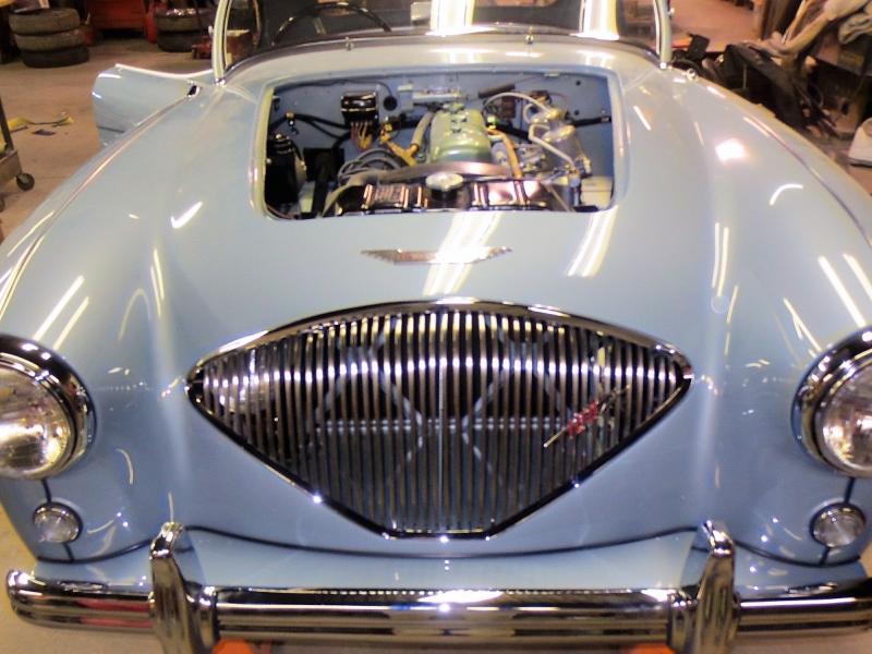

    I have a question about the X brace that sits behind the grille and in front of the radiator, should that be body color or black? On my car they are body color. It has been suggested that this is incorrect and that they should be satin black so that they are less visible? I would be interested in opinions on this? I am fairly certain that body color is correct, but want to get some more expert input.

    After a bit more research, what I am hearing is that most of the cars the X brace was body color, but that there are some exceptions, apparently white cars and some others had the X brace hand painted satin black. If any real experts can confirm that it would be great.

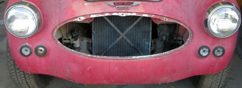

    Quote Originally Posted by steveg View Post
    Anderson/Moment -- 100s, P.29, caption - vertical panel and x-braces painted body color. P.147 for the convertibles, left column upper: brush-painted flat black except for the black cars. Roadsters - P.75 rt column, upper: brush-painted flat black except for black cars
    +1

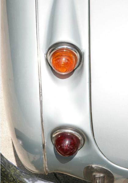

    Quote Originally Posted by Duane_Rhynard View Post
    +1
    Internet Photo
    My Original Tri-carb
    3000 MK II tri-carb with separate side lamps and flashing indicator lamps ? Never see that before.

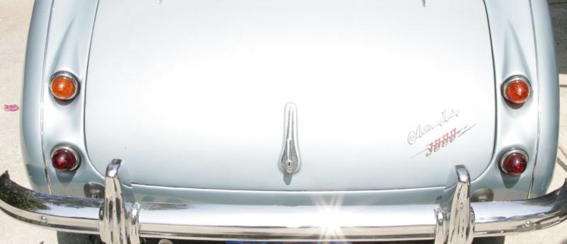

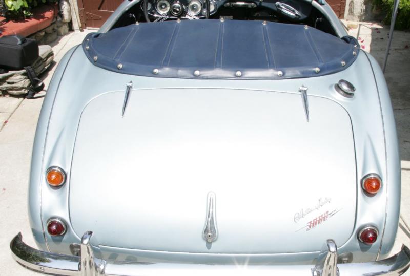

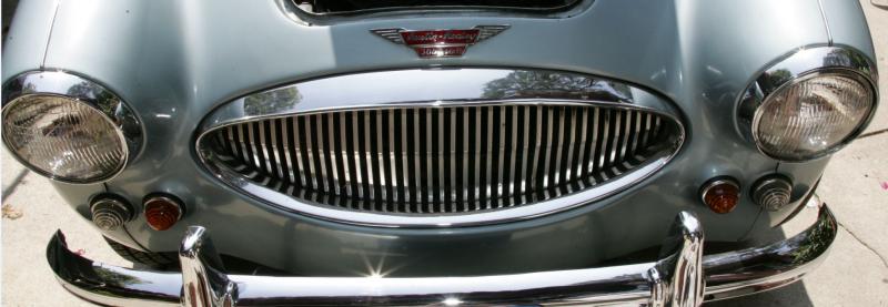

    Re: 100 X Brace Color?
    Quote Originally Posted by dougie View Post
    It is a German Export, cars for Germany and Sweden had separate lights on both the front and rear! Both the front and rear shrouds were modified to fit the lights! My research indicates there were less than 100 German and Swedish tri-carb exports with this configuration.

    Healey Blue (aka healey blue) also has a BT7 like that; also has steering column lock and octagonal hub nuts, several years before the US required them (January 1st, 1968).

    Quote Originally Posted by Randy Forbes View Post
    Clearly! At least I consistently get them wrong...
    Randy,
    You were very close, since the BN7, BT7, and the BJ7 all came in the glass two light configuration for Germany and Sweden!!!
    Thanks,
    Duane
    BN7
    BT7
    BJ7

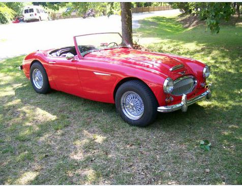

    Sure like that red one!
    I'd always been partial to the 2-seater, ever since R&T's article on all the Healey variants in the early 70s (June '72?). It's no wonder I fell for BN6L/942 when I saw it in Ray's shop (Healey West) around the Christmas Holidays 1977. He had it strategically parked next to the parts counter__which served as the cocktail bar__and the more I looked at it (along with the more I drank) the more I knew I had to have it. Seeing this, Ray knew he'd set the hook when he said "I'll finance it."
    The rest has been a continuing history.
    Getting back on topic, though my car was originally Healey Blue/OEW, and then silver by the time I bought it, the cross-piece was still painted a mat-black. I had cut it out sometime in the 80s to fit an electric fan, or it'd be Wine Red today (that's dark enough to not show through the grill).
