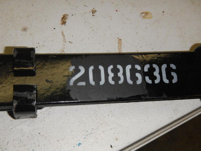

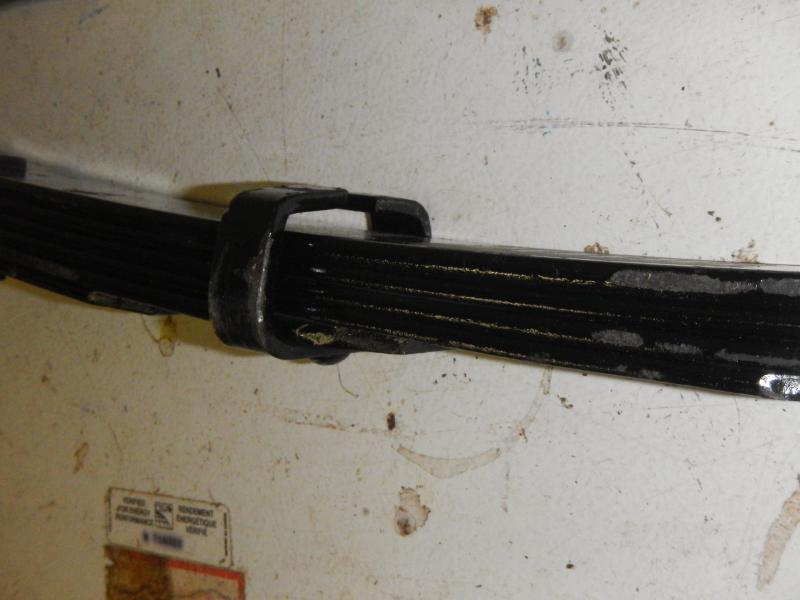

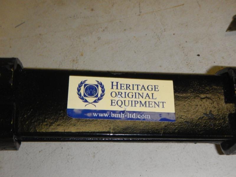

    I got a pair of springs from Rimmer Bro, in UK but was not happy with the quality. The rebound clips were 1/4" + clear of the top leaf and the leaves are thicker than the drawing calls for.
    I have been in contact with Mike Eaton of Eaton springs and with the TR drawing he says he can reproduce the springs as drawn including the tapered ends. But they are expensive for one set. Maybe several sets would bring the price down.

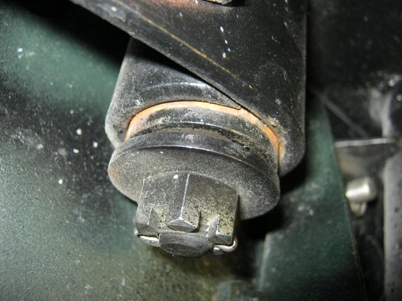

    Is this what the two ends of the bolt looks like?

    That's it. As mentioned, the bolt head has a flat on one side that rests against a complementary protrusion from the tube. I think I can just see the place where the two meet as indicated here:
    I am not aware of a body plug behind the seat though I have heard of some (in extreme cases) drilling a hole in the body behind the small stone guard to drive out that bolt.
    I started by soaking the whole thing well for many days in PBlaster. Then uses a bottoming tap in that threaded hole to get it as clean and deep as possibly. I used regular all-thread with success though some use harder stuff (grade 8?). Maybe I was lucky but on both TRs that bolt pulled out as smoothly as a cork out of a wine bottle.

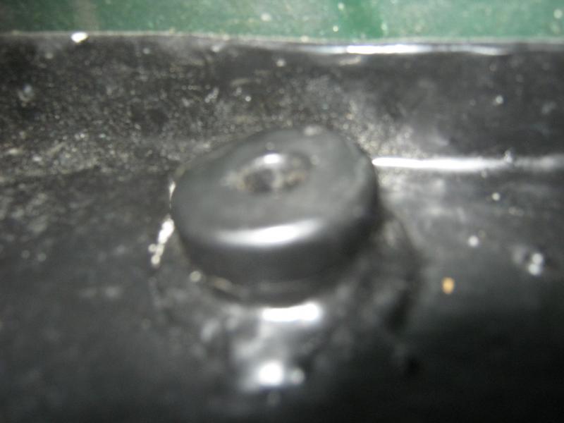

    The car is on jack stands so initially I didn't get a good look at the head of the bolt until I took a picture of it. The car has no rust under it so hopefully that bolt will come out easily.

    Most people can get those pins out by doing as Geo has done. Copious amounts of PB Blaster or Kroil over a several day period should loosen them enough to extract them. However, occasionally that will not work. I know that Don Elliot here on the forum has actually lifted the body up by the back enough to slide the leaf spring off the pin. If all else fails, there is the Revington TR method as shown in the link below. However, this method involves cutting the spring, and really doesn't sound any better than trying to get it out using Geo's method. But if desperate, it may work.
