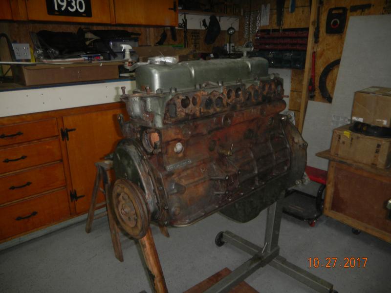

    well i have about run thru everything i can and only have the eingine left to get back in the car. since i bought the car in boxes, i have never heard the engine run. So i have no idea what i have there. hoping for the best.
    i am reading, and re-reading, the Bentley book. looking for any video i can find and searching the internet for any info and help on what to look for or be careful of as i take this engine apart. if you all have any tips or suggestions, please send them on. i hope to start this week once i finish up painting a few parts and taking care of a few misc things.

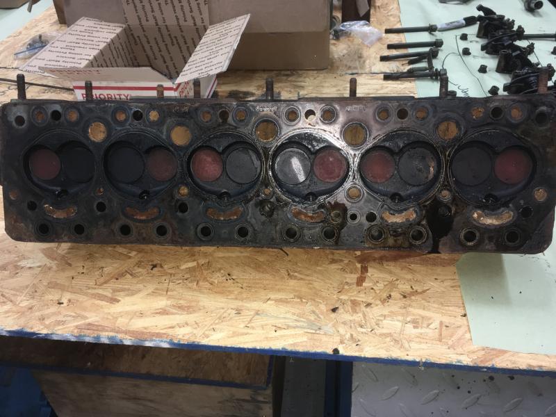

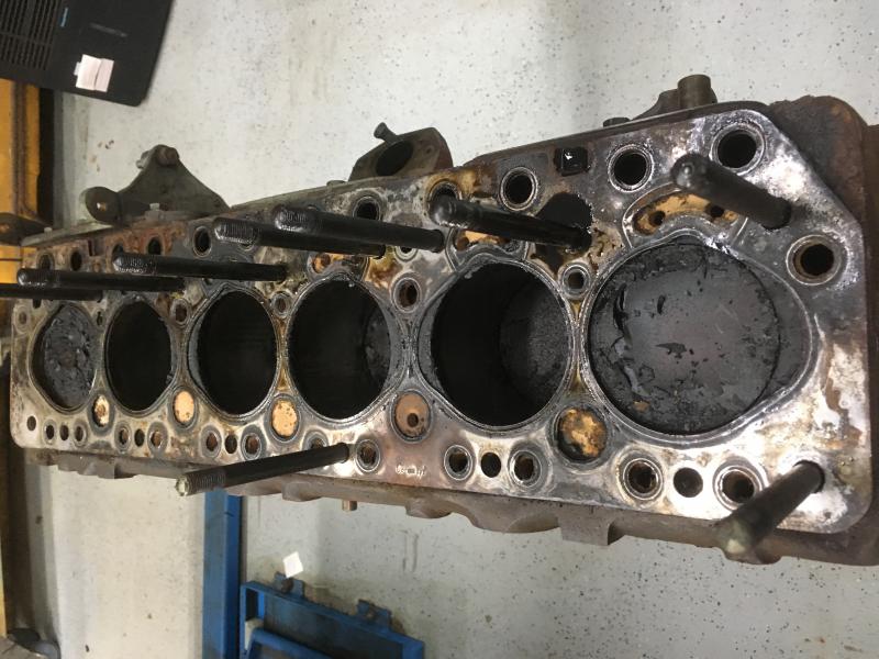

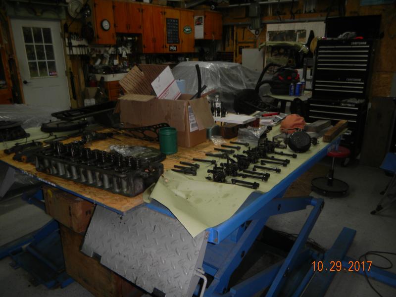

    well i started the tear down today. Nice to have the engine on a stand. a little aurprised by so much carbon on the pistons.
    but the cylinder walls looked really clean. i expected to see some scores there but i did not. Also a little surprised to see the red on the intake valves. would have thought that would have burned off before now. cleaning up and separating everything at this point. certainly there is some gunk.
    my valve compressor would not do the job to release the springs so i need to find one that will. tomorrow i plan to pull the oil pan off and then decide where to go from there. IMG_0259.jpgIMG_0260.jpg
    the first two pistons had a "TM" marked on them plus a "3" in a diamond. the other four pistons had an "ID7" on them and a "2" in a diamond.

    I bought my 1960 BN7 in 1981. It had 93,000 miles on it. It was “burning” a lot of oil which was caused by a badly worn rocker shaft which allowed oil to be sprayed into the valve cover and drawn into the carb where it was burned. I replaced the shaft with an oversized shaft and had the pedestal bushings rebored. Totally fixed the blue smoke and nothing else was done to the engine. It maintains 40 lbs. at 3000 when hot and 20 at idle. If you can meet or exceed these, I’d leave it alone. Recently I removed the oil pan and observed a pristine camshaft. I cleaned the gunk out of the pan and the screen of the oil pump and have very clean engine oil. A compression check should reveal the condition of the rings and or valves

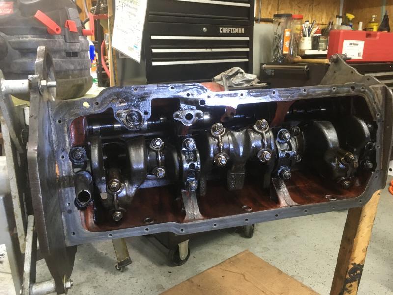

    Re: 62 / BT7 tri-carb engine
    Day 2 on the tear down. Mostly clean up and removing studs.

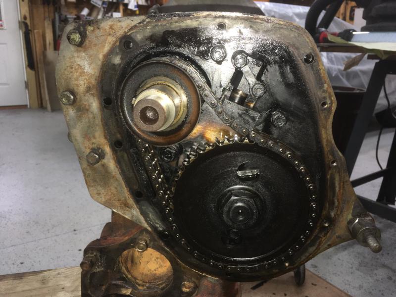

    i do wonder about the timing chain. it looks good and the sprockets look great. but it seemed to have more slack than i thought it would. i measured the distance the tensioner was extended and it came to just under 7/16". the travel on the tensioner looks like it could go to 7/8" and still work fine. can anybody shed some light on if i should replace the chain? i am going to replace the tensioner which has some scores worn in it. you can see a pic below.
    tomorrow i plan to look at the main bearings and see what they look like. plus start some cleaning of parts. i also noticed the cylinders in this engine had liners in them. looking at the Moss catalog they show liners for later models but not a BT7. Maybe someone can shed some light on that as well.
    oh, some other pics. always fun to look at.
    oh and i pulled the oil pan with the engine upright so i could look for anything, like shavings in the bottom. i found nothing there except some sludge. i also did not see any sign of anti-freeze in the oil.

    Liners no problem - all 3000 engines the same. New timing chain and tensioner inexpensive; seems like a good idea to replace.

    I'm no hexpert, but it appears to me your timing chain is a bit stretched, and the teeth in the cam gear are a bit sharp and have more of a '\_/' shape than a '|_|' shape (and the crank cog will likely be even more worn). Moss has a timing set with tensioner--although your tensioner may be OK--for under $200, and Tom's Import Toys will give you 15% off that. At the very least check timing at the correct valve lift (usually 0.050").

    as always, thanks for all the help.
    checked the main bearings today and they have to be replaced. three of the 4 looked like just wear a little in to the brass. but the thrid one was worse. So i spent the day pulling out the crank. of course with pulling the crank, i may as well pull everything out. i was hoping the engine had been redone at some point and this would be a quick run thru.... really, what was i thinking.. hahaha. Good thing is that i won't have to wonder now. So at this point i need to get it all out and start a list.
