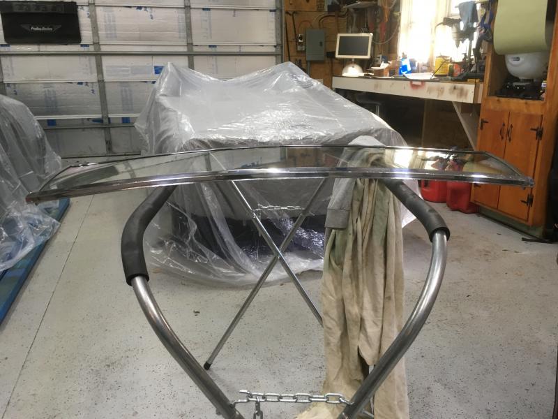

    my windshield has a number of wiper scratches in it and after trying to polish them out for a day, i gave up. they don't seem that deep but i guess i do not have the equipment to get the job done. So i took my glass over to the local auto glass shop and asked the guy if he could get me the glass. it needs new seals and all so i just wanted to get the glass. his book listed glass for a 63-67 Mark II but nothing for a 62.
    my question is: is that the same glass. my VIN number is 16183 so is it possible it uses the same glass as the 63? which i believe would be a BJ7 model. as you can see in the pic attached it is not flat glass.IMG_0255.jpg

    The BJ7 is a MK II (aka Mk IIA) as well and his book is showing glass for the BJ7 and the BJ8. It won't fit your car. Contact these folks, they may be able to help: http://www.prosourceglassintl.com/index.html They are local to me and offer very good prices.

    Glass for a 63-67 Healey will definitely not fit a BT7. As for polishing, it will work but takes a long time with the right equipment. I used an Eastwood kit and was happy with the result. The wiper tracks that were noticeable are now very faint. Having the windshield out of the car so you can work on a horizontal surface helps. It does make a mess, as you use plenty of water.

    Take a look at the Moss page: https://mossmotors.com/austin-healey...shield-mirrors You can see the BJ7 and BT7 windshields are different part #s. Moss carries the correct windshield for the BT7.
