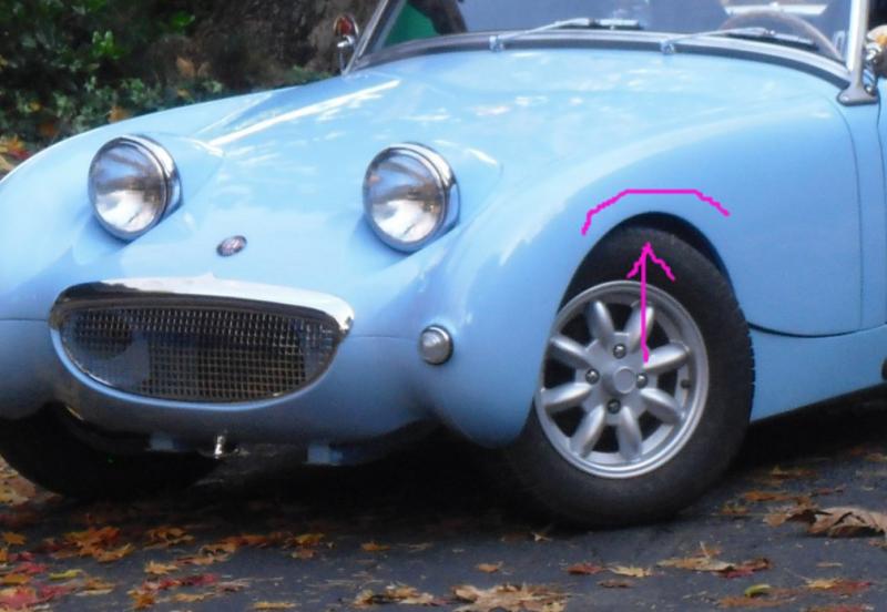

I know many say their wheels (tires) scrape on some turns, but I think mine do more than they should (or more than most). Yeah, I have over-sized tires, but at the recent All British Field Meet I did a brief comparison of cars in the Bugeye row... and my front clearance (top of wheel to fender arch) was the smallest of the bunch. So, I'm wondering about my front springs. Although I should have done more comparisons/measurements, I failed to do that.

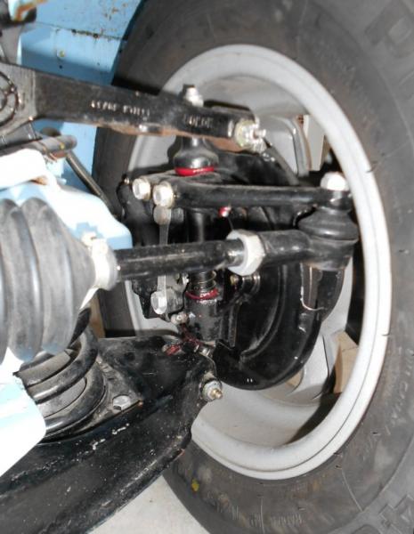

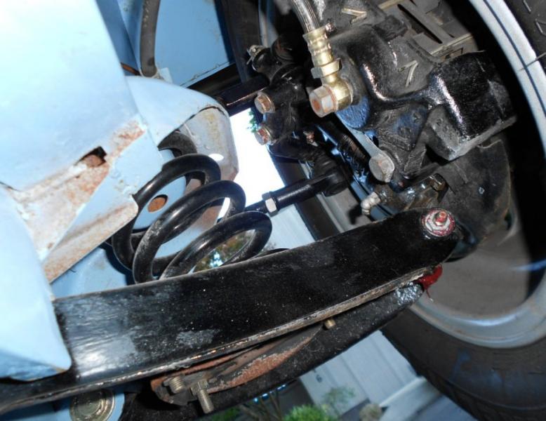

So, I'm inquiring about common dimensions that anyone can offer (that might get me to believing I need to investigate the front springs - because they are either worn of the previous owner modified them like they did the rear leaf-springs). I'm pretty sure my original lever-arm shocks are fine. Sample pics attached.
Knowing that tires will be a factor, are there common dimensions I can look for... like control arm to ground or something else? Or is there an easy way to know (other than the clearance) that I need to improve this?

Thanks Gary (I was going to email you direct too). Here's another thought that might be fully independent of tires... the distance from the center of the wheel hub to the top of the arch. Might be more universal?
I'm running same as you (175/70x13). 6" seems crazy high, but you mean to the inside of the wheel arch (top), right? How about from the top of the tire to the top of the exterior fender arch?

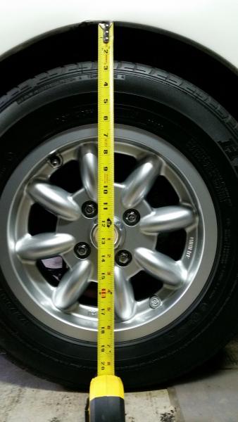

6 inches from top of wheel and 13 inches from center hub to bottom inside of wheel arch (+/-). Also about 1 1/2 inches from to of tire to wheel arch, but a lot more variable with that.

Most excellent!!! Thank you. Although I'll go measure mine, your wheel gap looks larger than mine. Every little bit might help.

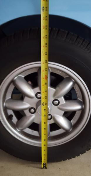

EDIT: yep, there's less room with mine. It appears that the center of the hub to the exterior fender arch is more like 12.5". That 1/2" might be substantial. Gap from tire to exterior arch might be not that much under 1.5"... maybe 1.25" (but as you say, variable). As the photo indicates, about 23.5" from floor to exterior arch. Hmmm.

Did you make sure there are no spacers between the lower a-arm and the spring pan?

Common practice for lowering a spridget is adding spacers to lower the spring pan. 1/4" spacer would lower the car approximately 1/2" due to geometry.
