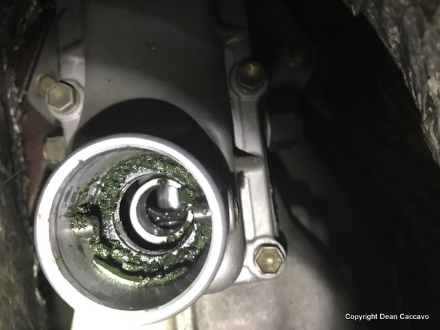

    I just replaced mine last weekend. Driving along PCH I found that I could not engage 5th. Here is what the bushing looked like. Completely crumbled. It took 5 minutes to replace, and most of that time was vacuuming the old bushing out. Our local Autozone had them on the shelf.
    Here is a link to the Dorman part on Summit... https://www.summitracing.com/int/par...rese1-_-dorman

    Quote Originally Posted by HealeyBN7 View Post
    Dean
    That's a great price for both pieces. Also, very easy to check if the old one is worn out.

    John, before you assume that the trans has to come out, the shift tower seat and shift rod detent balls and springs are easily serviceable with trans installed. I would highly recommend at least looking at them before giving up.
    Dean
    Good to know they're available in the aftermarket. Dorman has always been good at supplying hard-to-get or common-to-fail items. The seat shown is the "green" one and my parts guys tell me it is the most common. The Toyota # for that is 33505-35020.

    Right. Dorman provides two bushings in the package. The green bushing is the sleeve for the ball joint, and the white smaller bushing fits onto the end of the shifter and into the shift fork components farther inside the transmission. I read that some folks had difficulty getting the white bushing to fit. I had this same issue. It may be that the ID of the bushing is too small for the shifter and that forces the OD to be too large for the fork, or it is just too large to begin with. I suppose it is possible to machine it to fit better, but at that point you might as well start with a new piece of delrin. In any case, the green bushing works fine, and it is unlikely your white bushing is bad, so don't go about throwing away the old white bushing before you test fit the new one.
    Or maybe my advice should be...toss the Dorman white bushing in the trash and pretend that you only got the green on that you ordered.

    Under each of the three cap screws you will first find a spring. After removing the spring, you will probably need a small magnet to remove the ball. Their entire purpose is to create a little extra pressure on the shift rod when it is in gear or in neutral. It does this by pushing the ball into an appropriately located notch on the rod. My main concern here is that, since all 3 sets don't show the same part #, that perhaps the wrong combo was used in the bottom(5th gear) location. We have a W58 "training" unit at work. I will see if I can get some pics to make this easier to understand.

    Thanks Craig. Pictures would certainly help.
