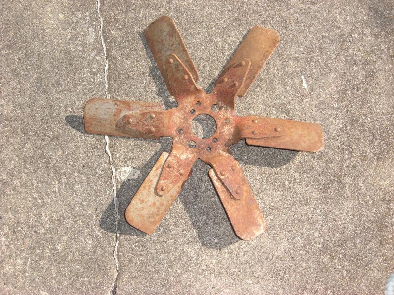

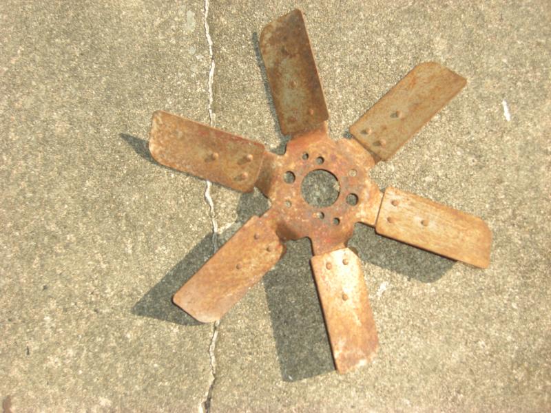

    CIMG0064.jpgCIMG0063.jpgJeff this is what I found and don't know if this is what we are looking for. It does not fit the crank case holes but maybe a waterpump. Can't remember where they went on the early ones and I looked at the ends of the blades and it seems they were square. Getting old is not for sissies.

    Re: Original GT6 Mk 1 cooling fan
    Jeff, this is the only rivet fan I found in all my stacks and I don't think it's the one we are talking about. This might be off a Mustang but the holes do not line up for the crank pulley, but may do on a water pump, don't have one to check right now and I think the blades were square on the end.

    Hi Peter - I'm fairly certain these in the US were on the GT6+. On the MK.1 in the US, I believe the fan in 1968 was the same as that on the 67 - pressed steel with aluminum blades. I could be wrong as I'm having a devil of a time finding documentation.

    Interesting Wayne. On the GT6 they went on the crankshaft pulley. I wonder what car this one is from. Many thanks for digging this up, and hold on to it as in the end I may have to improvise. Jeff
