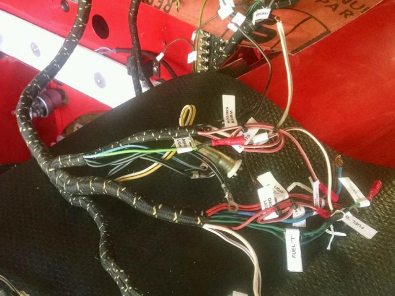

    --referring to the diagram, label all the wire ends; I had to staple the labels to keep them from separating. You can do this in the comfort of your living room - this minimizes confusion time lying on your back looking up under the dashboard.

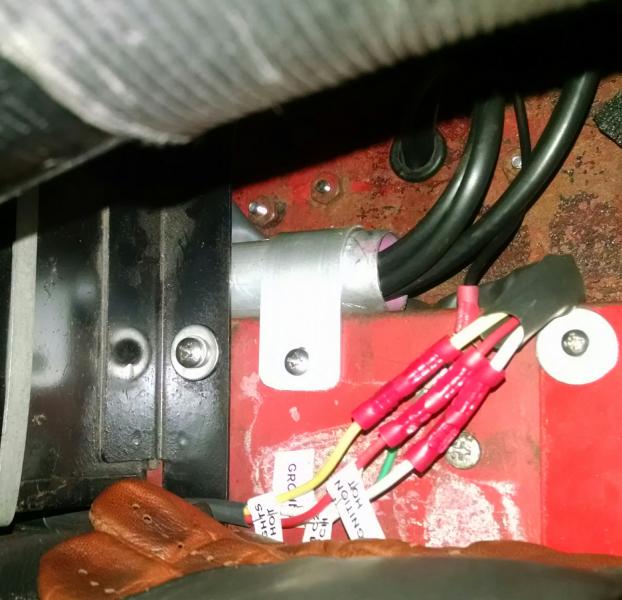

    --I made a conduit from 1" thinwall alum. tubing, which runs across the heater plenum behind the heater. This makes it easier to snake accessory wires behind the heater box

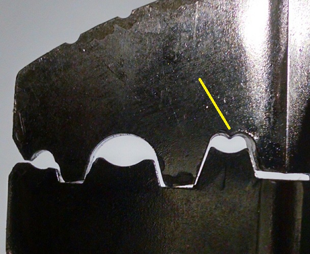

    Your crimp tool should have the little point at the yellow arrow:

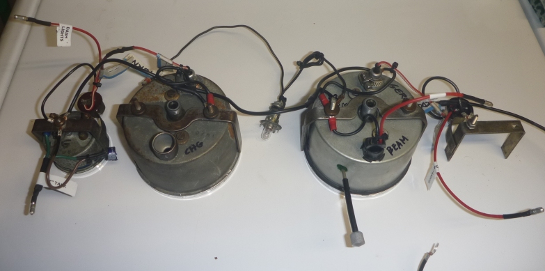

    Made a separate harness for grounding the gauge lamps. IMO they're poorly grounded through the mounting clamps:

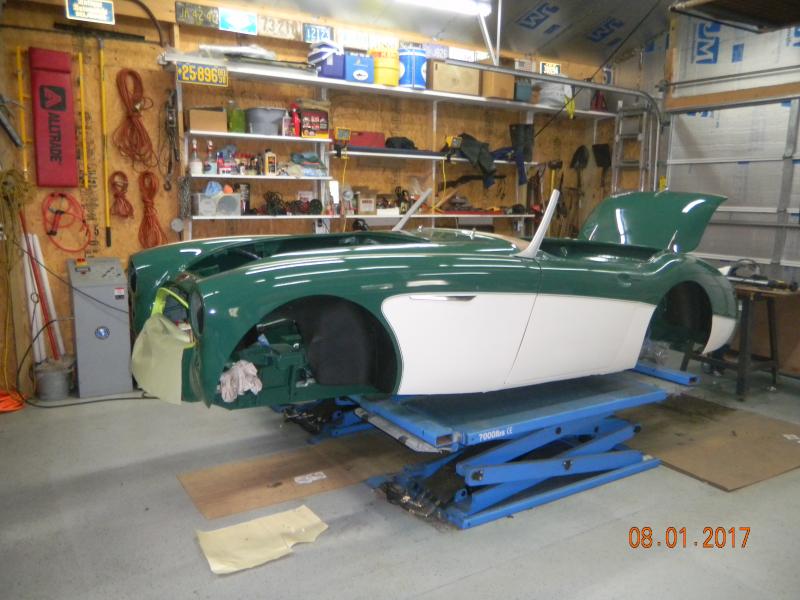

    Bob, i will include a pic of my car below to help. but basically it is stripped down. Not trying to do a concours. but a nice driver. i do have a schematic but only a little one. i will look into a larger one. i had looked at the pics on BCS but i forgot about them. i will go back.

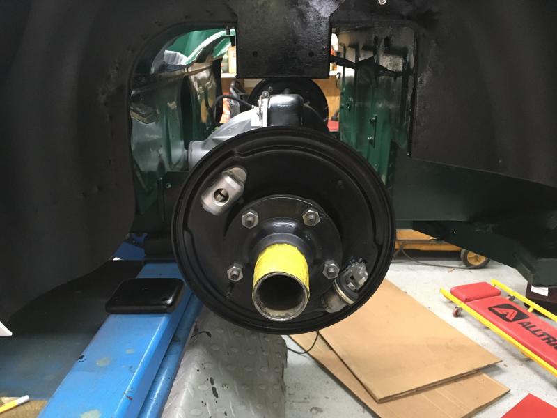

    i have pulled the rear harness up under the car and screwed it to the frame up to the front. all the lines and the wiring that went from front to back i pulled out so i had plenty of pictures to reference. but once i get forward of the rear, it is all guess work for me.

    Conduit held in place by bent strips of 1/16" x 1" aluminum:
