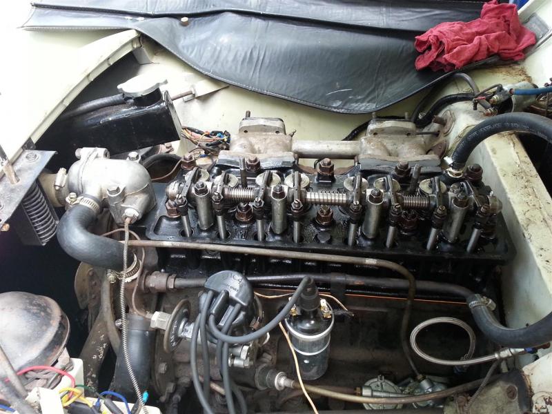

So here is the situation:
TR3, mileage unknown
When I started to work on it, bad overheating, replaced radiator, much better but still a little overheating
A few hacks present under the hood when I got it has led me to believe less than skilled hands have been touching it in the past
But over after carb overhaul, distro work, etc engine has been running good, 115 lbs plus on compression
Carbs removed again and manifold removed to ease exhaust system work which is now mostly complete
Today before replacing manifold decided to unstick block drain while still readily accessible (the dreaded "while I'm in there...")
Result is valve was clear, block is not - fully plugged with hard crud, even after clearing with drift and drill only get coolant seepage
My instinct is to pull the head and try to ream out the coolant passages in the block
Questions:
1. We are far enough down that only a few steps remain to pull the head. Any tips, like what to do if it's stuck? Do the head studs have to be pulled as well? What about the trick of turning over the engine with the plugs in or will that do damage?
2. With the head off can I get to the passages enough to try to remove the garm?
3. If I pull the head I suppose I should take it to my machinist. Any things he should do or not do? Should I replace the springs?
Thanks, Dave

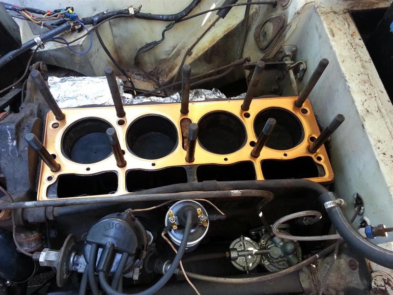

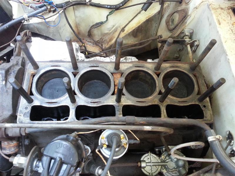

OK, head is off. It came off kicking and screaming, but it's out now. Pics coming tomorrow.
To keep the liners clamped, I was thinking using the block studs with pipe as a spacer and then large washers covering the ends of the sleeves?
Cheers, Dave

Should work fine. I normally drop a couple of big sockets over the stud.
Geo Hahn
Typical set-up using sockets:
I put a couple of pieces of cereal box cardboard over the wells for the pushrods/cam. I am just the sort to drop something in there.

Daves1957TR-3

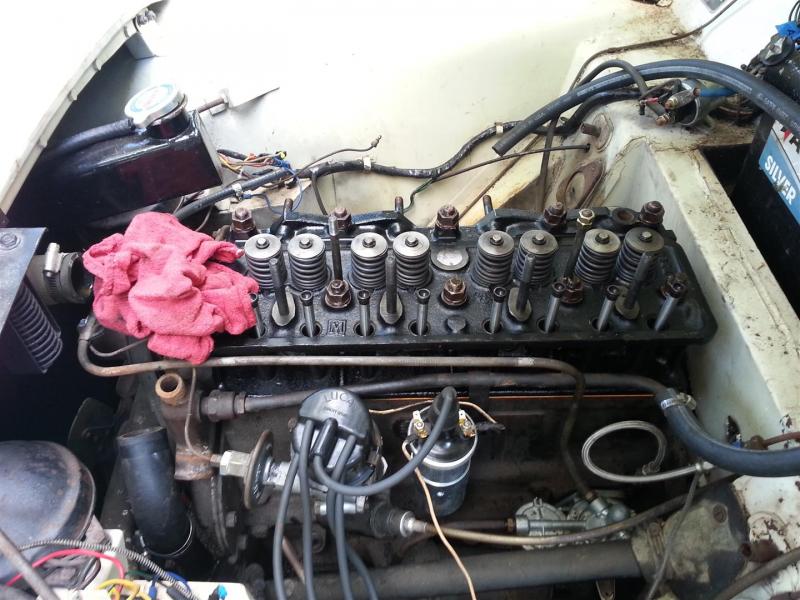

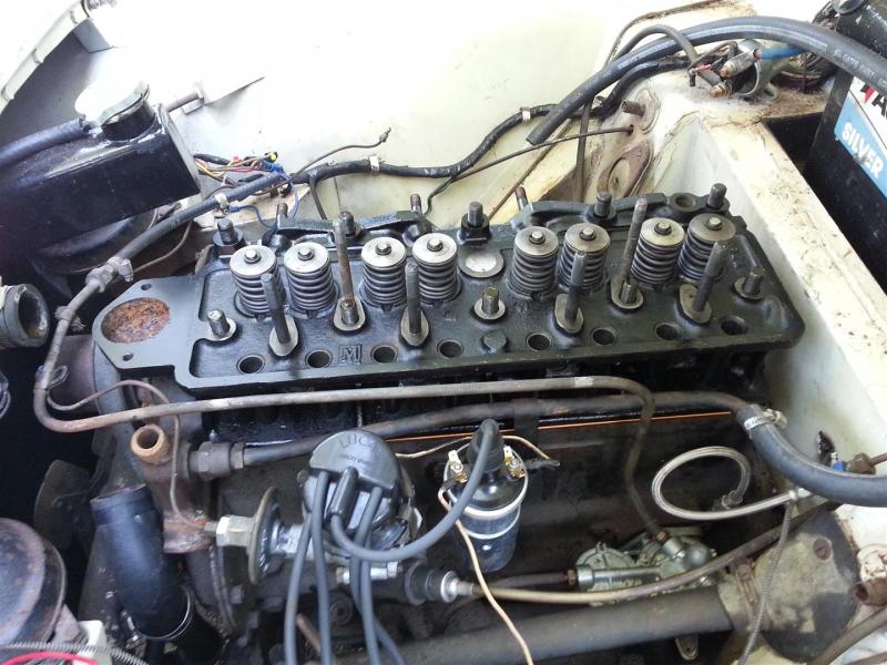

So here are the pics. It can be seen that the solidified crud in the head behind #4 comes up to about 3/4" below the block surface. Lots of work ahead. The head doesn't look too bad, but my thought is new springs, maybe new valves? Should I have my machinist harden the seats, if not done already? Also, something about not hot tanking the head due to aluminum pushrod guides? I will check tomorrow on pushrod diam and valve stem diam, hopefully get parts ordered tmw.
20170731_174320.jpg20170731_174325.jpg20170731_174332.jpg20170731_174338.jpg20170727_191528.jpg20170727_191533.jpg20170731_165024.jpg

I'd take at least a few valves out, at least one intake and one exhaust (probably #4 since it tends to run hottest) and have a look at the faces. It's hard to tell anything just looking at the top of the head (unless it's really badly burned, which yours don't seem to be). Also hold the valve with the head just 1/4" or so off the seat and try to move the head sideways. Any significant movement indicates the guide and/or stem is worn.
If all seems fine, put it back together. Your valve springs have been working, so I'd leave them alone rather than risk getting new ones that aren't as good.
But more likely, you'll find the exhaust seats at least somewhat burned, in which case I'd replace them. Valves can be refaced several times, but eventually need replacement. And if you're going to change them anyway, I suggest considering the later valves with 5/16 stems (plus the conversion guides of course). In my limited experience, they last longer and flow better.
