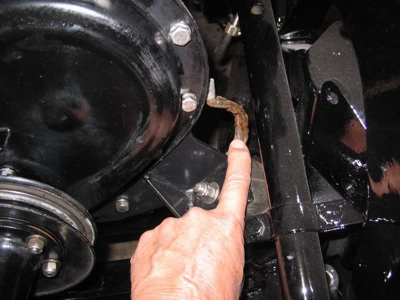

On another matter, can you weigh in on my question about where the chassis to motor ground strap is fitted?
On a TR3, it's at the LH front motor mount, from one of the timing cover bolts down to the rear bolt holding the mount to the frame. I assume TR4/4A is similar, but not certain. (Photo courtesy Don Elliott)

motor to chassis ground
Unfortunately the TR4 has a different motor mount. I guess I can figure something out
