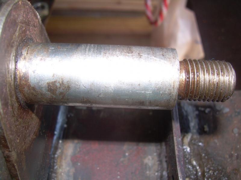

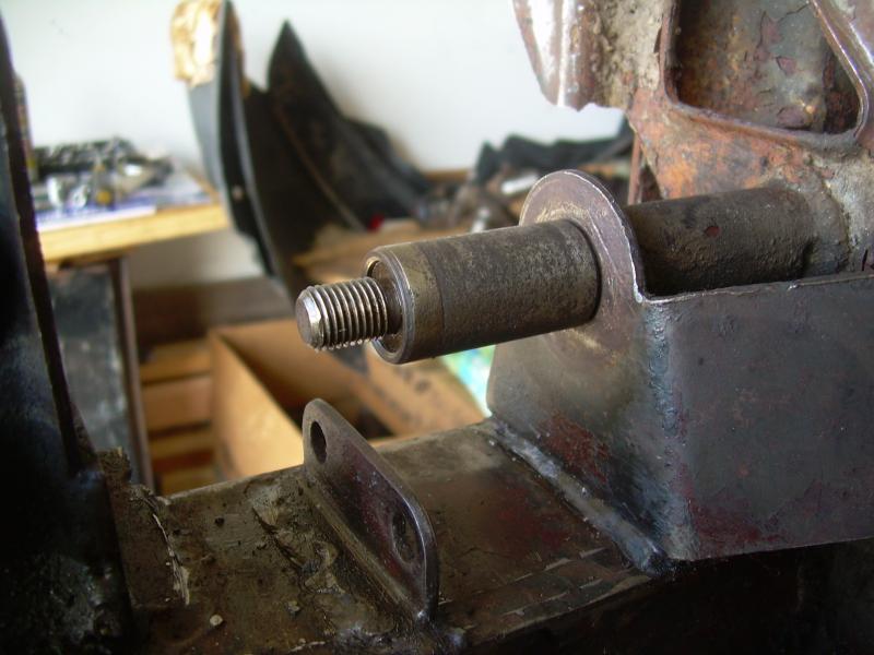

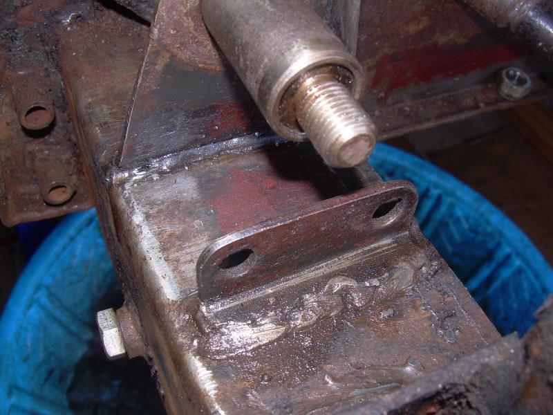

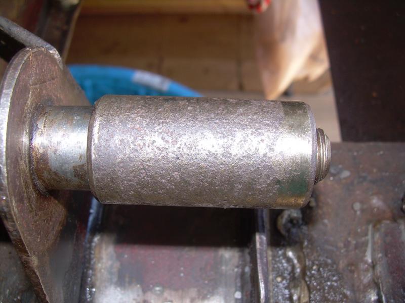

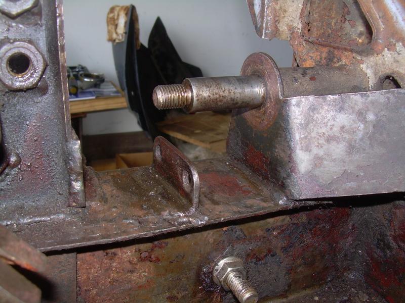

    So collectively, I got all the info that I needed.
    This AM (my 80th Bday) I put some heat to the forward STEEL Bushing & it came right off the through shaft.
    The photos are for sp53 (I wasn't ignoring your request) & those who may have a similar experience in the future.
    Thanks to all who responded
