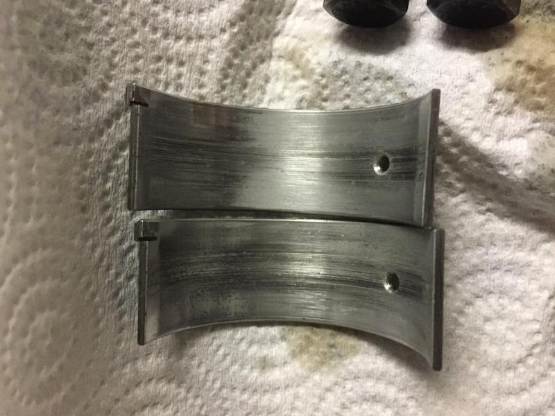

The cam cam looks good (that's an oil smudge) and the bearings look ok as well, but I'm not sure the tolerances. Is there anything else I should check while I'm here?
CJD
That looks good. Were the bolts tight? What size bearings were installed? It should be stamped on the back.

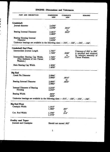

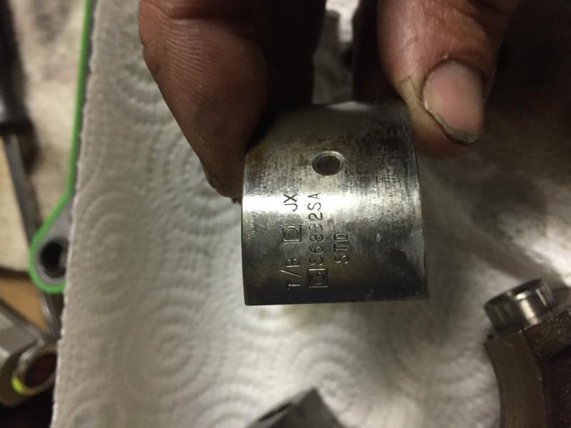

The bolts were tight (breaker bar tight). The bearings have stamps, but not a size... is there a cross reference?
