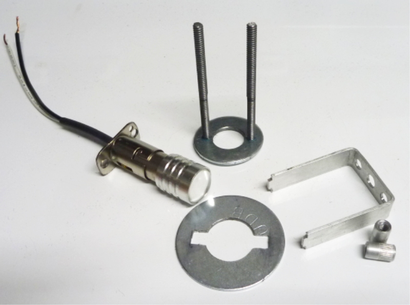

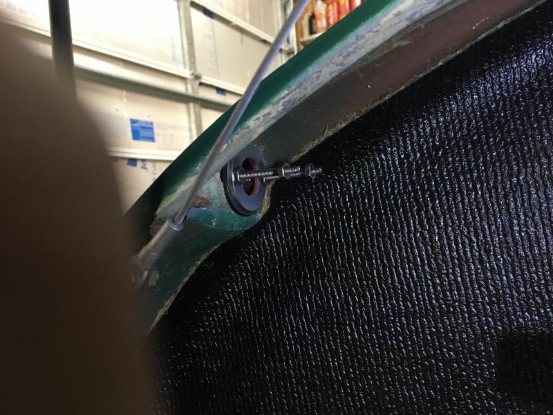

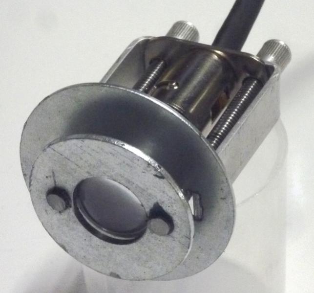

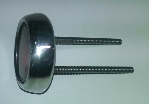

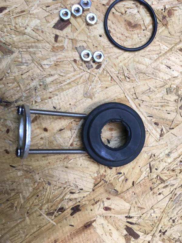

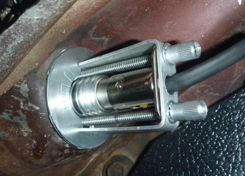

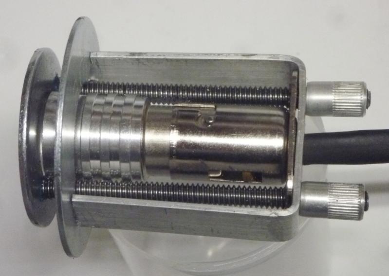

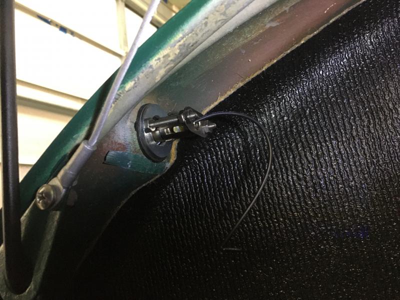

    After I melted my first set of reflectors with halogen bulbs...
    ...following John T's lead, converted my reflectors to the LED 1156s:
    I like to mechanically clamp the lights to the shroud.
    I have the original-shape reflector bezels and wanted to keep their rubbers which have the large holes previously made for the halogen reflectors.
    LEDtailSocket1.jpg Smaller washer fits inside rubber; LED light rim rests against 3/4" hole; 10-24 rods are loctited in place; thumbnuts made from 10-24 rivet nuts. Yoke 1/2" x 1/16" aluminum. Large washer made from 2" fender washer.
    Large washer may be eliminated as the yoke can bear directly against the shroud. I covered it with 3 layers of duct tape to help seal off the opening as the lens rubber doesn't seal all that well.
    Addendum: the depth of the yoke is pretty inflexible. It's determined by the distance from the shroud to the flange on the bulb socket with the small washer installed in the rubber and firmly pressed against the outside of the shroud. I had to file away the threads adjacent to the bulb slightly for clearance. The spacing of the threaded rods is determined by the span of the holes on the bulb socket mounting plate.
    In retrospect: if one were to use the large washer, keying the yoke to the square openings is unnecessary. One could just file openings for the threaded rods with a rattail file and have the yoke butt directly against the washer surface. Neither the yoke nor washer are going anywhere - this would make it easier to adjust the length of the yoke.

    I'm impressed, and I'm hard to please!
    Very clever and robust; I can imagine how long it took to make/adapt the the pieces. The thumb-nuts: how ingenious!
