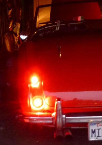

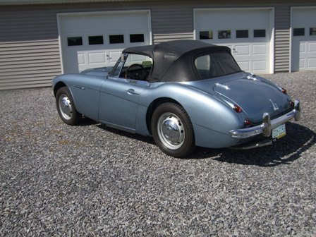

    Hi Griz, I have just been studying Steve's method of putting the extra light where the rear reflector is on the 100/6 and BJ7 cars. In Steve's method, the top light will act exactly as the bottom light on each side except for the running light part. Meaning the top light will be a brake light and a turnsignal light AT THE SAME TIME THAT THE BOTTOM LIGHT WILL BE. This will certainly brighten things up back there. The running light will stay the same as it is on the bottom bulb.
    My BJ7 was delivered to Germany when first produced and as such it is one of a few that has what was referred to as an early Euro lighting arrangement. In that it has the light configuration like a later BJ8. When I restored my car after driving it for some years, my wiring harness was shot. There is no wiring harness in the aftermarket for a car such as mine, it has an early dashboard arrangement and later lighting arrangement. I had a choice to buy an early 100/6 / BJ7 harness or a BJ8 harness. Either way I would have to modify the harness. I chose the early 100/6/BJ7 harness thinking that to rearrange a BJ8 harness to match my dash would be a pain. Alas, I may have chosen unwisely because to make my lighting work with the earlier harness I would have to eliminate the brake/turnsignal flasher relay box on the inner left front fender well. Well that's what I did and here are the mods necessary to make your rear lights configured to perform exactly as a BJ8. Refer to the pics of the relay box and the rear of my car for example. You will be eliminating the relay box. the wire on the relay box that is at top left of the drawing and marked as coming from the brake switch is to be taken off the box as well as the wires on terminals 7 & 3 marked left & right brake filaments and these 3 wires are to be spliced together. This will turn on the brake filaments when the pedal is pushed. Terminal number 1 is flasher power coming from the cylindrical Turnsignal flasher. This wire will be removed from the brake/flasher relay and extended to the common wire at the bottom of the steering box. This is the center common terminal in the trafficator. Right now (before modification) the right and left wires of the trafficator pull the brake/flasher relay to the left or right respectively, they will no longer be attached to the relay. So the wires on terminal #4 and terminal #2 will be taken off and will be spliced together. the wires on terminal #8 and 6 will be taken of the relay and spliced together. This will effectively make the trafficator turn on the right and left turnsignals. To make the back turnsignals work you have to add a wire for each side to the rear. The top lights on the BJ8 are amber and are the turnsignals. So to make this new light work you will run a new wire from the splice of wires you took off of terminals 2 &4 for the left side to the left rear turnsignal location. For the right side, you will run a new wire from the splice of the wires you took off of terminals 6 & 8 to the right side rear turnsignal location.
    I realize this is a much more involved mod to get the extra lighting in the rear. It all depends what you want and this will give you two options to choose from. See pics.
    Attached Images Attached Images

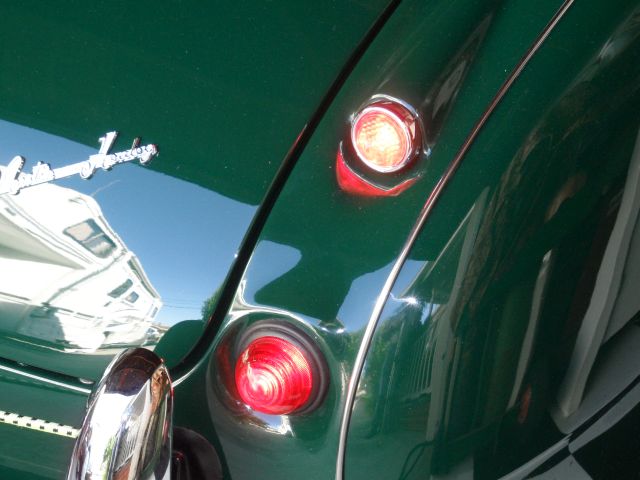

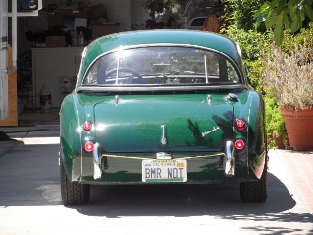

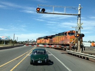

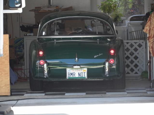

    Agreed Steve. One well-known Healey expert's opinion was that the turn signals / brake lights are on for only a short time, so they wouldn’t generate enough heat to damage the plastic. This is true most of the time, except:
    Also, I again wonder about twice the current flow through the thin wire, and the resulting load on the relays. This is where LEDs might have some application, so I ordered a pair of 7 Watt red LEDs with 1156 bases. 1156 bases have only a single contact. The result:
    Maybe better seen in the shade:
    Turns out the LEDs are at least as bright as the original brake lights with halogen bulbs:
    The LEDs and sockets are available from Amazon:

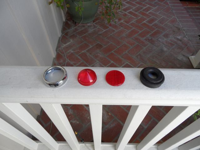

    The reflectors easily come apart. I have a BN4 with the cone-shaped reflector.

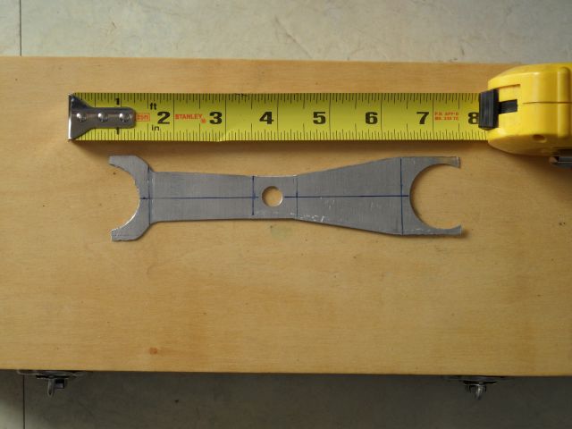

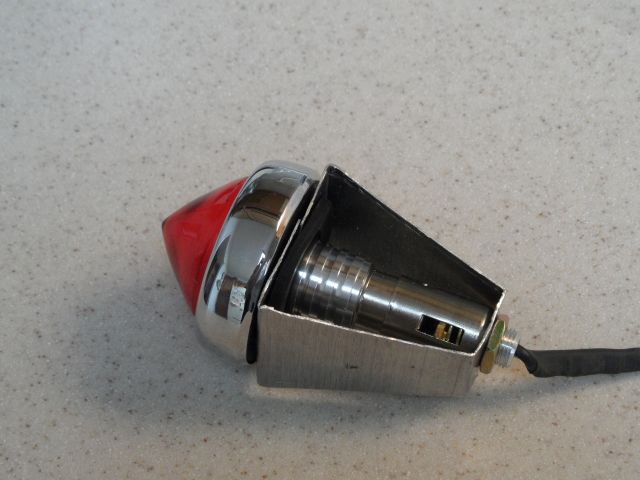

    Using a water-based surfactant (In this case, 409 cleaner) and a 3/4” Forstner bit, I drilled a hole in the middle of the rubber piece. The LEDs are about 0.78” in diameter, so the rubber will hold them.
    I then used some 0.025” aluminum and made a holder that hooks behind the rubber flange inside the shroud.
    The cutout is like this:
    The end on the left is the top, because the shroud is rounded above the reflector. The large circles at the ends are 1 1/4” diameter, although 1 1/8” should work. The thread on the end of the socket is 1/8” pipe thread; the nut is available in the electrical department of your local hardware store.
    The reflector is installed in the shroud, the bulb and socket is installed in the holder, the bulb is pushed into the rubber opening and the holder ends hooked between the rubber and backside of the shroud. The wires are connected to the black and white/purple or white/brown wires in the tail light with connectors in between to make removal easier.
    If you look carefully at the reflector, there is one side labelled “TOP”. I assume that should be at the top.
    Because the load from the incandescent tail light is still there, no change is required to the flasher relay.

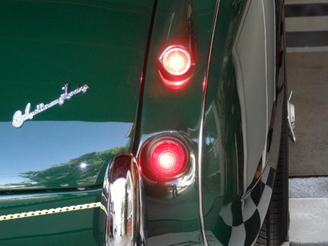

    The LEDs I'm using are not multi-directional, but because of the reflector, there is a wide dispersion of the light. They have a single surface-mount LED behind a lens:
    I had seen your comments earlier about viewing at an angle, so I took some off-center photos. This one is at about 30-deg off center.
    John, BN4

    Quote Originally Posted by Griz View Post
    .... The hole is for my planned conversion to LED lights. Following up with that idea, I've learned that LED lights are polarity sensitive and I have yet to decide if I will be converting to negative ground. I'm still checking with distributors, but has anyone discovered a source for positive ground 1157 LED's?
    Griz
    If you are putting LEDs behind the reflectors, you want 1156 LEDs, not 1157. 1157 bulbs have a low intensity mode (tail lights) and a high intensity mode (brake and turn signal). The LEDs behind the reflectors only function as brake lights/turn signals.
    Of all the 1157 LEDs I've looked at, they were either not bright enough or the difference between low and high intensity wasn't big enough to adequately alert the drivers behind, not to mention positive ground. (I converted to negative ground for an alternator). What I did for the regular tail/brake/turn light was obtain some bulbs from the hot rod boys that increased the candlepower from 21 Hi/6 Lo to 50 Hi/14 Lo. Best source I found was https://www.bobdrake.com/FordItem.as...1A-13465-HP12V.
    John, BN4

    Re: Rear reflectors BJ7
    John,
    I thought the pictures of your tail lights seemed brighter then standard and the bulbs you referenced seem a very good addition I would like. How is the heat generation of these high output incandescents?
    Ray(64BJ8P1)
