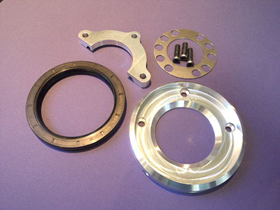

Any of the above can be causes for the leak, but typically, it's the scroll seal. If all other measures prove fruitless, I make a seal kit for the rear main that works.
This link will give you some insight into the working of the scroll seal:
https://gerardsgarage.com/Garage/Te...rdsgarage.com/Garage/Tech/SealKit/SealKit.htm

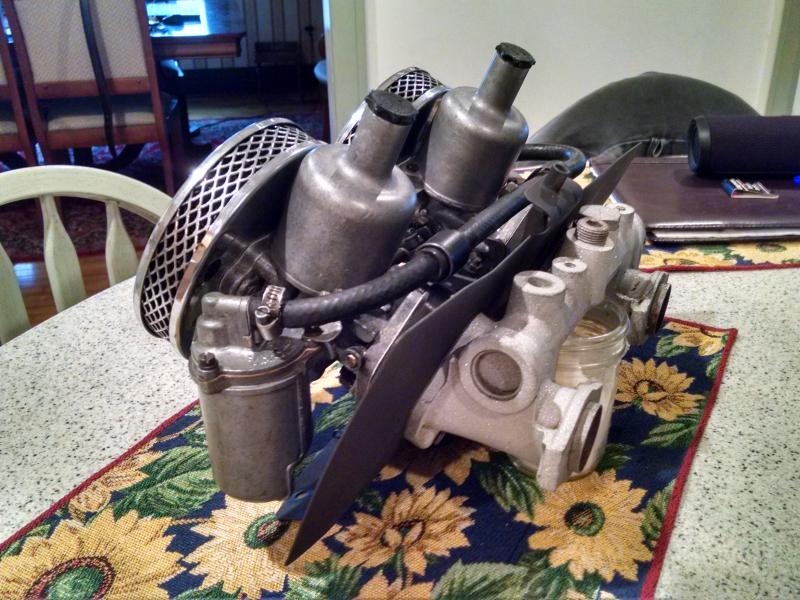

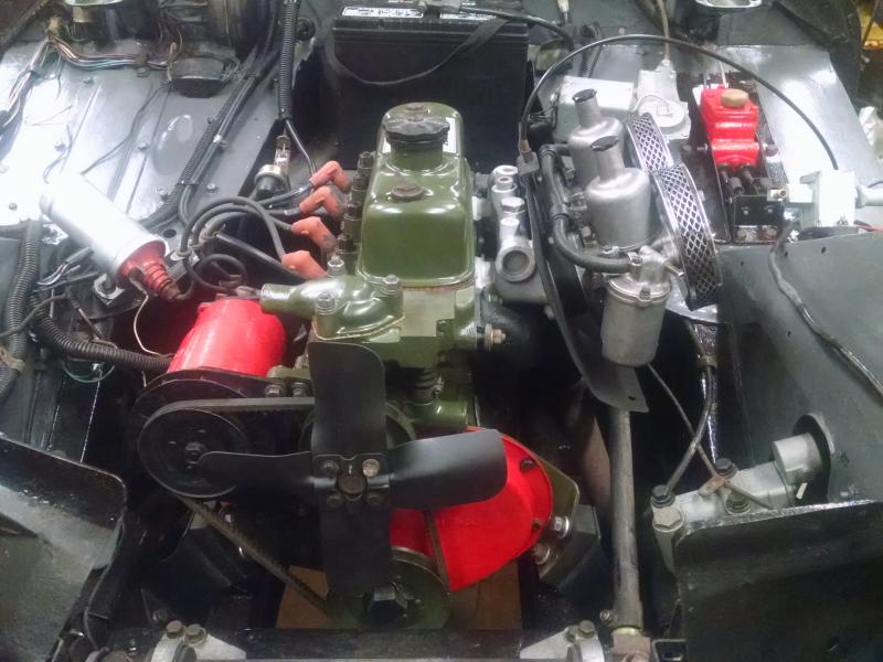

The PCV setup depends on the carbs you have. Can you post pix of the engine that way you have it now? In particular, I need to dee the carbs and manifold you are using. Do you have the carb with the brass tubes angled towards each other?

Attached are a couple pics I found on my phone.
The intake does have a nice 1/4 or 3/8" tapped hole available. No hole in the valve cover thought. That can be remidied.

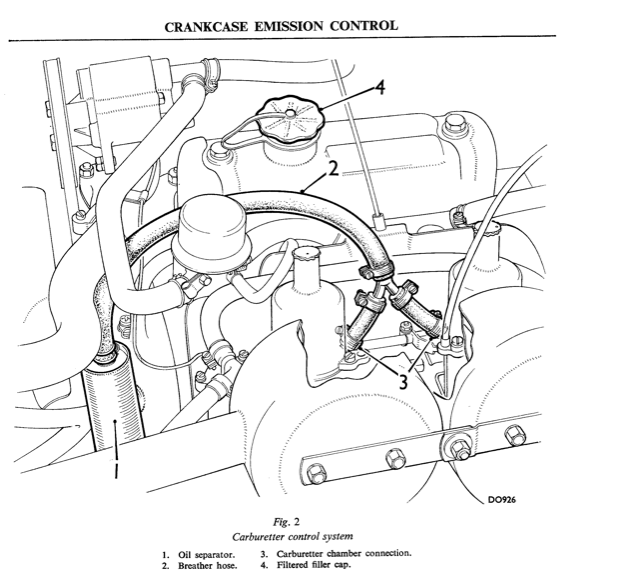

Well, I can't see if you have the vent tubes or not. The valve cover with you vent would be the type that would have those carbs, but those are easily changed. I suggest you use only the Smith PCV, and attach it accordingly. (see attached diagrams for whichever cabs you have. You don't need to add a vent to the valve cover.

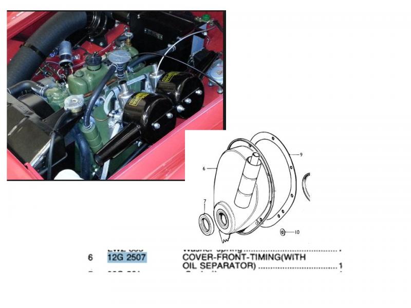

I also just noticed that you don't have the correct timing chain cover for a 1275. I'm sure this is not helping either.

It was pointed out that I had the wrong timing cover for the 1275 engine. The correct one with a port and oil separator for PCV is no longer available . After some searching I found one. Installed it, installed the Smith PCV on the intake manifold. And low and behold, I ran the engine for 1/2 hour on Saturday and not a hint of a leak. Conculsion, PCV is a must on the 1275 engine.
