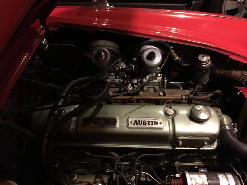

Just picked up our car after many updates including a modification of the crankcase breather. Apparently on the later model 3000 there is crankcase ventilation which on my car had been routed through the valve cover, the valve cover having then been fitted with a "breather". Unfortunately the breather was venting engine oil in considerable quantities that was then cascading over the generator among other things. In discussing this with the shop, the decision was made to put a "blank off plate" over the current breather location and re-route the breather tube down towards the ground.
Problem is, when we were almost home, I discovered that the "chase car" following me home had a windshield that was covered with oil! When I arrived home, after the car was shut off it delivered maybe a 1/2 pint or more of oil onto the floor of my garage.
Contacted the mechanic who told me that it was "blow by" and that my engine needed to be rebuilt.
Maybe. But the compression on all cylinders seemed good before he began work.
It is almost like there is a vacuum that has been created and oil is being siphoned right out of the engine.
Do I just need to pony up for a complete engine rebuild, or is there another possible scenario? If I can figure out how to upload pictures of the current configuration I will post them.
Thanks in advance for any guidance.

Clearly your "mechanic" isnt familiar with Healeys . That vent hose should go to the rear carb so the vented fumes etc get reburned in the combustion cycle .
Having said that if you do have a lot of oil coming from the vent hose then you are looking at a rebuild . Unless theres way to much oil in the engine ???

In reviewing your pictures and the blank placed in the valve cover by your mechanic, was a PCV-modification made to your engine ventilation previously and, if not, do you know the purpose being served by routing an additional crankcase vent tube to that portion of the valve cover?
A while back, some installed a PCV into the intake manifold and, as part of that modification, a seal was added to eliminate original ventilation through the oil filler cap. As a result of a PCV installation modification, oil vapor created within the engine (mainly the crankcase) would be directed to the PCV and Drawn into the manifold to be combusted and exhausted. If the PCV has been eliminated incompletely and/or improperly from eliminated and partially retroacted to the original internal ventilation configuration of the engine, substantial oil vapor could be pressurized and pushed through other then proper engine orifices in quantities far greater then normal.
I would go through the engine and reestablish what would happen if all tubes, connections, and seals (i.e. oil filler cap) are as original and non-modified before I would suspect further engine work need be done.

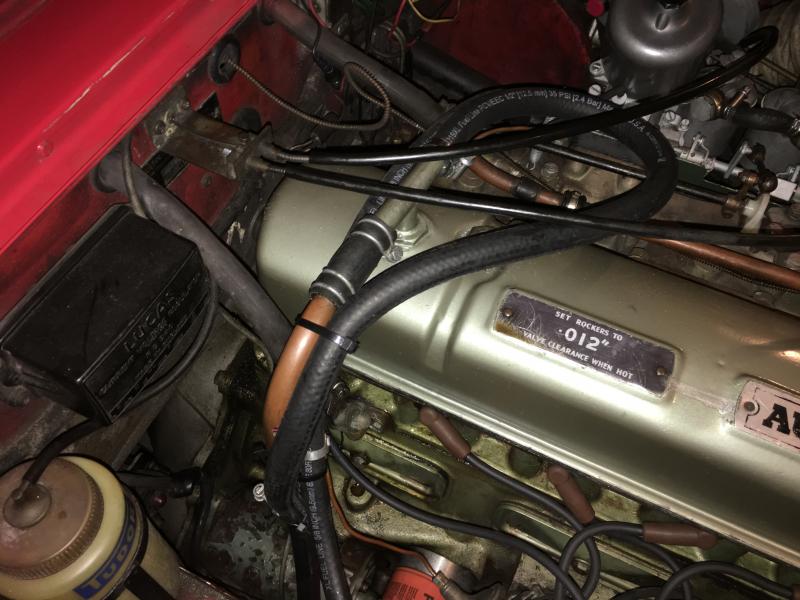

Check the "T" fitting on the valve cover it may be screwed in too far.
Also if there is a PCV valve fitted get rid of it.

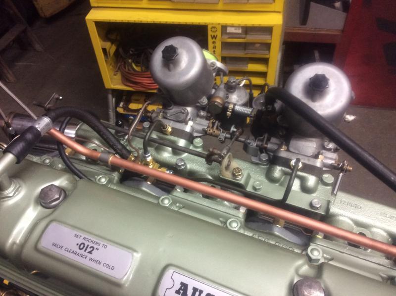

Here is my new PCV installation:
My engine builder--who also happens to be a licensed A&P (airframe and powerplant) mechanic--was adamant that PCV was the way to go; he just didn't like my previous installation into the small vacuum port on the rear of the manifold (it required the rear carb to be set way rich). So far, only a couple hours on the engine stand and in the car--no miles--but the engine hasn't leaked a drop of oil. PCV systems do the best job of removing blow-by gases and water that form acids in the oil.

also Mert has it right. Here's the way I configured mine about 10 years ago. Also we have had some really lengthy discussions about this before. Here's a link to one of them.
https://www.britishcarforum.com/bcf...my-new-air-filters-have-no-connection-for-one
Realize that the crankcase must be vented. If you are just circulating the crankcase air around and thru some hoses and back into the crankcase you are not venting anything and you will build up pressure and blow out gaskets, which of course drops oil all over the floor, etc.
Bob's mechanic is quit correct here. (he must be the exception to my previous statement about shop mechanics :smile: ) But you must have a ventilation system along with the recirculation system. For the PCV valve to suck air in, it must come in from some where. Usually a vented cap or a hose stuck into an air cleaner.

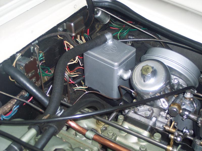

Now that's what I call a proper Healey PCV arrangement. What PCV have you chosen for the setup? I wonder if an Oil Catch Can installed between the valve cover "T" and PCV also help improve performance by extracting heavy vapor and oil/water condensation prior to gasses passing through the PCV.
If, as many have suggested, much of the oil is coming from worn bushings on the valve train, I would still question how Hutchster's engine ventilation is arranged and, if a previous PCV setup was installed, has the oil filler cap been returned to being vented? Just think what a mess it would cause if the valve train was leaking and the filler cap was sealed!!!

Bob , im intrigued by your PCV mods .
The PCV outlet goes to some sort of valve/manifold but is hidden in the pic behing the copper heater tube . I see you also have tubes going it the carb spacers . I assume these are where the PCV products eventually enter the combustion cycle .
Do you have a close up/ better pic of the manifold where the PCV outlet connects to it .
I see you also have a vacuum connection to the manifold so the PCV valve will operate .
It's not a 'manifold,' per se, just a 3-way fitting so that the flow from the crankcase can be divided to the two tubes that go to each carb. The garage is shut down tonight, I'll get a shot tomorrow. It's nothing tricky, just a way to balance the vent flow to both carbs, so they can run the same mixture setting.

The lower hose is connected to the Girling power brake servo. The oil catch can's output tube, on the side, is just connected to the rear air cleaner. I had originally designed the catch can's output to be connected to a PCV but was concerned about its potential affect on my brake booster if a shared manifold port were created or, if an additional manifold port was drilled, what the affect of both vacuum draws would be on the rear carburetor. However, reviewing Bob's arrangement, I can see how drawing on both carburetors would provide an even, consistent, and sufficient vacuum draw to move even heavy vapor contaminants from the engine.
However, selecting an appropriate PCV has always seemed a random choice and one primarily made for hose fit. Way back when the first PCV's began to appear on Healeys, someone selected a unit installed on an AMC Eagle Premier I6 ...if I remember correctly...and these units should now be scarcer then hens teeth. Although I do like the idea of using a PCV, the uncertainty of selecting a properly sized PCV and its potential affect on the nearby draw for my brake booster had stopped me from moving further. Although Bob's setup eliminates my booster draw concern. the proper selection of a PCV still remains.
