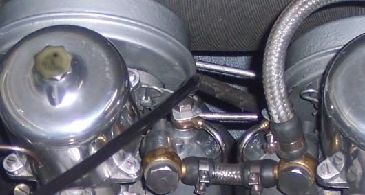

One other question....has anyone found a easier method of attaching the air cleaners to the carb? The front one is not too bad but the back takes me at least a 1/2 hour and usually includes hunting for a nut or lock washer that fell "somewhere".....then has to be fished out from the depths of the engine compartment with a suitable magnet....:censored:

Hi Chet,
On my BJ8 with 2 HD8 carburetors, I use 1 bolt and a pin (with washer) inserted into a drilled through stud for center attachment of each carburetor. The approach provides a tight fit and eliminates quite a bit of hassle.
Ray(64BJ8P1)

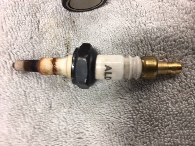

Today I decided to pull all 6 spark plugs and check them. Started with number 6 and worked my way forward. 6 and 5 looked "brownish", 4 was black (definitely rich), 3 and 2 were "brownish" and #1 was....well....broken.
Fortunately I was able to use a screw extractor to get the core of that spark plug out of the engine without damaging anything. I replaced all 6 spark plugs and now the car runs great with both air cleaners attached:encouragement:.
Just wondering if anyone else has had this happen to them with a spark plug?
Not heard of this problem in Healeys, but Ford had a massive problem with broken plugs in some of their OHC V8s (different cause, though). I'd: 1) not use that brand of plug again and 2) put some antiseize--preferably nickel or copper--on the threads next time I install plugs and 3) torque carefully (they really don't have to be 'gorilla'd' down).
Michael Oritt
It is not difficult to break a spark plug's insulator by getting the socket "out of square" to the head. esp. if there is no rubber liner to help with alignment.
bdcvg
Check with the spark plug manufacturer on the use of anti-seize, some plugs threads are coated with a metal that acts as anti-seize and recommend You NOT use the paste.
Thanks for this info. I recently changed plugs in my 2008 Mustang GT and was confused that anti-seize wasn't mentioned in the shop manual (I put it on anyway, and reduced torque setting slightly). The original plugs came out easily and didn't seem to have any anti-seize on them; I should have taken that as a clue. I suspect it's pretty much only newer cars/plugs that come with the metal 'anti-seize,' but don't know for sure. The newer, pre-coated plug threads seem to have a brass-colored, 'anodized' look to them.
John Turney
Since I have an aluminum head, I didn't want to take a chance on galvanic corrosion. The three brands of plugs that I have tried weren't coated with any anti-seize from the manufacturer.
