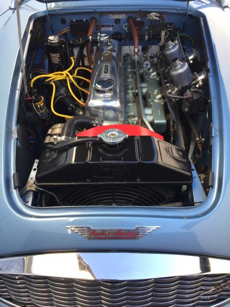

I run triple 2" SU HD8's with a Ruddspeed manifold on my '57 100-6 MM vintage racer which produces plenty of performance. I designed and fabricated my own heat shield to look factory original and my motor is totally ungraded for vintage racing, dyno (rolling road) tuned for total output. I love the look of the SU's on the Ruddspeed even though Webers will provide a little more HP.
These pics show up brighter, taken a little more than three decades ago (>30 years) at a Healey event held at Cypress Gardens, Florida. It's possible that Reid may have some details about the car, as I only recall it being a BN7, but he was a member of the host club at the time (maybe still is?).

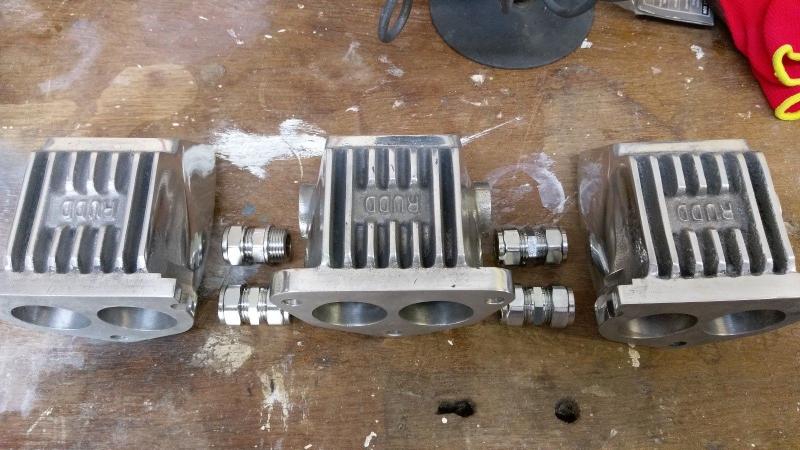

Notice that these are a different pattern, with the balance conduit on the top surface.
The car sporting them was shown pre-restoration, but it was however, driven to the event! BTW, that's my BN6L/942 in the center-background (with primer around the freshly installed fender vents).
I did take away a couple of momentos though (the trophies were awarded June 6, 1985, the picture of them being more recent) :cheers:
Please forgive the pictures being larger than I typically post, but I thought the greater detail around the #1 carb would be appreciated, and if you're going to do one...

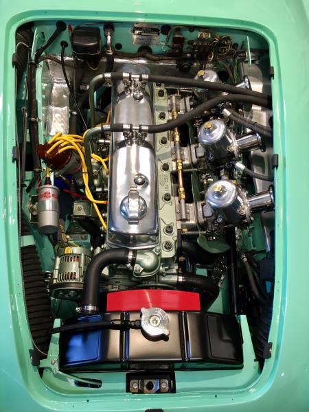

Here is a set up with a Ruddspeed valve cover as well. I believe this one was one of the new versions that were re-produced in the early 2000s when the Ruddspeed brand was re-formed. I think it has disappeared again.

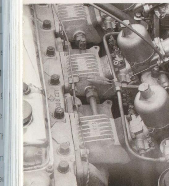

There must have been 2 types of period casting of the Ruddspeed manifold, mine looks like Randy's example which will accomadate a hi-performance free-flowing header design. The other with the lower integral balance pipes as see here on the 1960, former Bill Bolton owned Canadian Championship winning 3000 # 171.

Yes Dougie, there have been 2 different castings for Ruddspeed manifolds. The ribbed manifolds were for RHD cars. The smooth manifolds are designed to clear the steering column on LHD cars.
I believe those shown are the ones for the RH drive cars. There were LH and RH drive manifolds.
